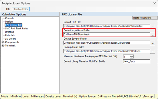

Downloading FPX files from Parts on Demand (POD) places them on your computer "/Downloads" folder.
To automate importing the FPX files in the "/Downloads" folder,
go to 'Tools > Options > FPX Library File > Default Import from
Folder > C:\Users\Computer name\Downloads'.

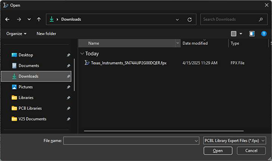

When you select the Library Editor toolbar 'Import Another
FPX Library File' it will automatically open the /Downloads folder where
the FPX files are.
Select the FPX file and 'Open' button or double click on the FPX file to load it into Footprint Expert Library Editor.
If there are multiple FPX files, select the first one and Shift Click the last one and select the Open button.
