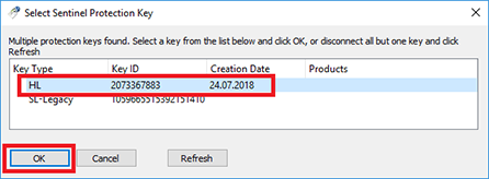

6. Key Selection - this only displays if there are two or more PCB Libraries keys detected. Select "HL"

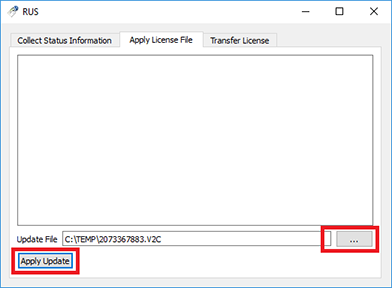

8. Once you get the V2C file from us, save it on your computer, then click "Apply License Update" tab.
9. Select the V2C file sent to you and click [Apply Update] button.

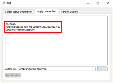

10. Success message should appear.
