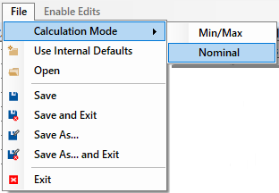

There are 2 Calculation Modes, Min/Max & Nominal.
1. To select between the two options, select "File > Calculation Mode", then either "Min/Max" or "Nominal".

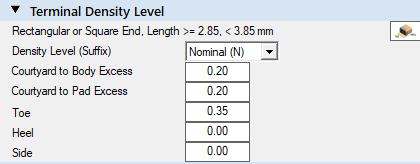

3. The Nominal Mode does not use package and terminal tolerances. Chose this option if you use Manufacturer Recommended patterns, or if you use hard coded solder joint goals. Solder joint goals in this mode are based on the FED Volume 18 standard.

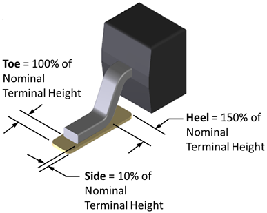

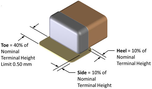

5. The FED Vol 18 standard uses nominal package dimensions. This greatly simplifies dimensional data entry and users control the Toe, Heel and Side for every terminal shape. Solder joint goals are created by using the nominal package terminal lead height or lead frame thickness. Below are 2 examples that illustrate the percentages used to calculate the Toe, Heel and Side.
The new Nominal calculation mode allows users to hard code the Toe, Heel and Side solder joint goal values and the results are predictable and repeatable.
Note: Modern machines and manufacturing processes for electronic components and PCBs are highly accurate, producing components and assemblies that closely adhere to nominal dimensions. Most component manufacturers recommend solder patterns in their datasheets based on Nominal package dimensions with pre-defined solder joint goals. Few component manufacturers use the IPC-7351 mathematical model, which incorporates manufacturing tolerances. Component package tolerances differ widely between manufacturers, complicating footprint standardization. This raises questions about the necessity and accuracy of these tolerances. Are they practical and realistic?
EXAMPLE 1 - Rectangular End Cap (Chip) Leads:

EXAMPLE 2 - Gullwing Leads:
