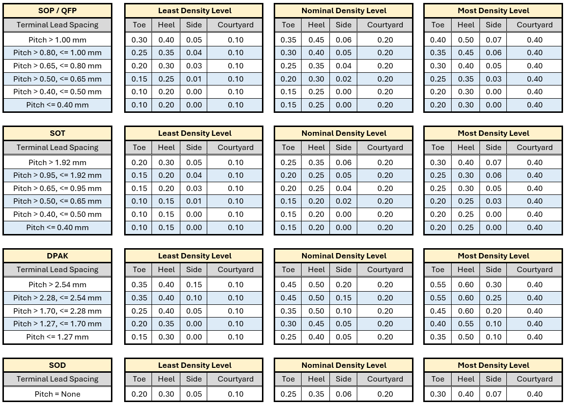

The Min/Max Calculation section was originally inspired by IPC-7351 and subsequently by the superseding IPC-7352 - Generic Guideline for Land Pattern Design. The solder joint goals were derived from the IPC J-STD-001G - Requirements for Soldered Electrical and Electronic Assemblies. For more details, see Appendix I.
Gullwing Leads (SOP, QFP, SOT, DPAK, SOD)

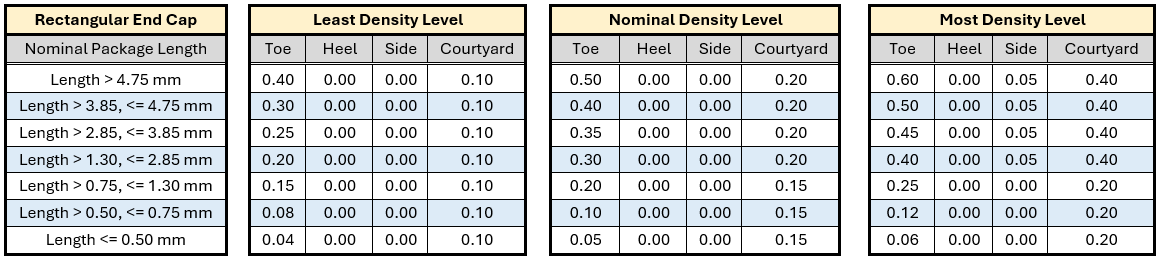

Rectangular and Square-End Cap (Chips)

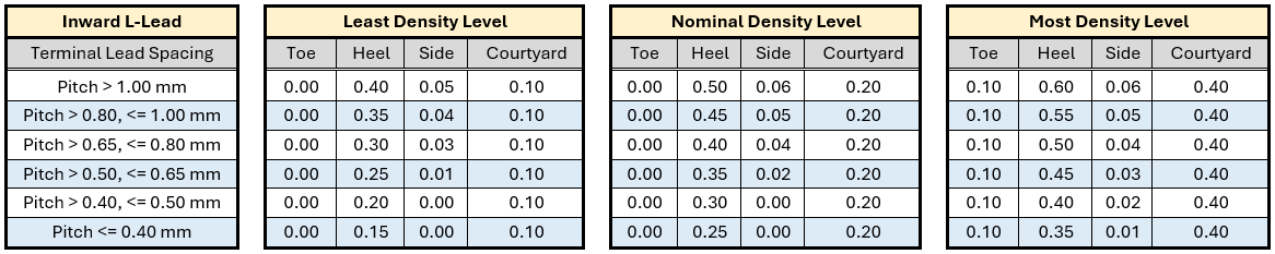

Inward L Lead Oscillator and Small Outline L-Lead (SOL)

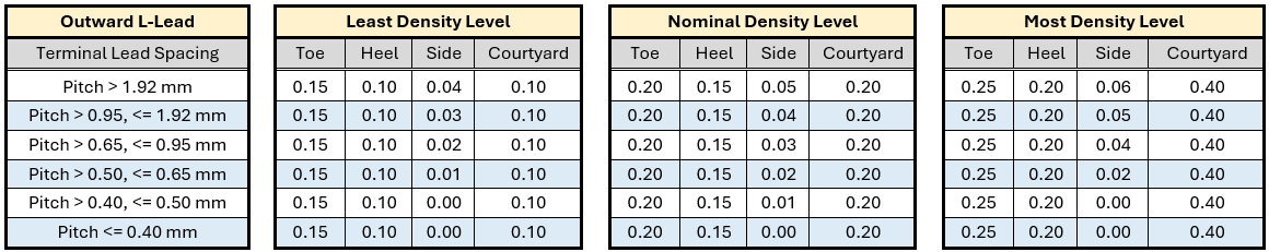

Outward L-Lead (SOT)

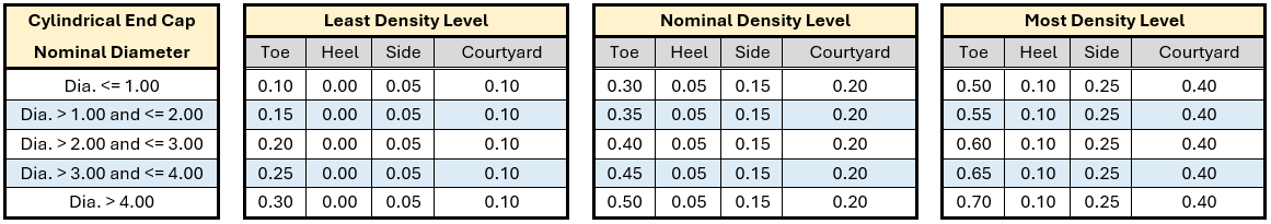

Cylindrical End Cap (MELF)

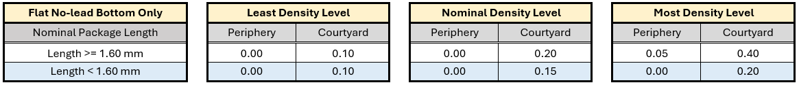

Small Outline Flat No-Lead Bottom (DFN, LGA, PSON, PQFN)

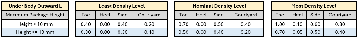

Under-Body Outward L-Lead (Aluminum Electrolytic Capacitor, Crystal)

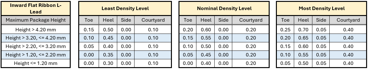

Inward Flat Ribbon L-Lead (Molded Body)

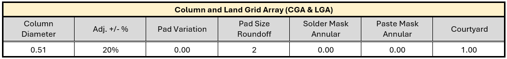

Column and Land Grid Array (CGA & LGA)

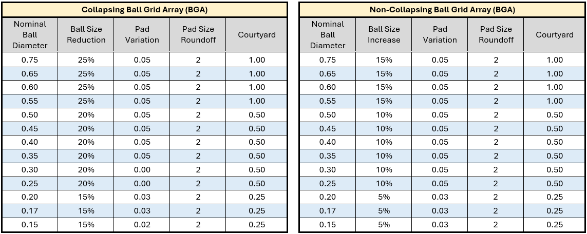

Collapsing and Non-Collapsing Ball Grid Array (BGA)
