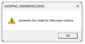

Allow Expanded Outline: Allows expansion as required in order to add an outline to micro-miniature parts.
Error message when Expanded Outline Off:

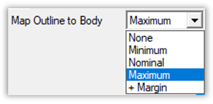

Map Outline to Body: This drop-down menu sets the size of the silkscreen outline relative to the component body.
The default value is "Maximum".

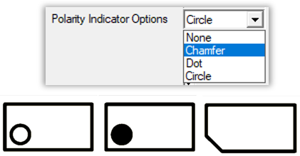

Polarity Indicator Options
Pin 1 Dot/Circle Size Not Larger/Not Smaller Than: The silkscreen polarity dot size is automatically calculated to adjust to the component while maintaining a size within the range of these two values. Making the values equal results in a fixed dot size. The Chamfer also automatically adjusts the component size to maintain a size within the range of 1/3 the lesser of body height or width, not to exceed 1 millimeter.
Add Polarity Bar To 2 Pin Parts: When checked, polarity Indicator options are replaced by wide line at the pin 1 location of polarized 2 pin parts.

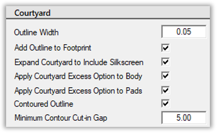

Courtyard Options
General: A courtyard defines the minimum clearance area around a component's footprint to ensure manufacturability, assembly, and rework-ability. It is not part of any electrical circuit but is critical for mechanical and process requirements. The courtyard to body is mapped to the maximum package dimensions.
Outline Width: User definable.
Add Outline to Footprint: Enables or disables addition of the Courtyard to the footprint.
Expand Courtyard to Include Silkscreen: Allows expansion of the Courtyard to encompass the Silkscreen outline in situations where the Silkscreen size exceeds the Courtyard.
Apply Courtyard Excess to Body/Pads: When checked, does not add the excess over body, or pads respectively, to courtyard. Note: The Expand Courtyard to Include Silkscreen is not affected by this option.
Courtyard Excess values: These values are not found in the Courtyard Drafting Options but are included with Terminal Options and, as such, unique to each terminal type - grid arrays, surface mount and thru-hole.
Contoured Courtyard: When checked, allows the Courtyard to conform to irregular shapes that might be present in the footprint.
Rectangular Courtyard: This was the original IPC-SM-782 courtyard shape.
Minimum Cut in Gap: This option defines the minimum size of a space that can included by a Courtyard contour. Values smaller than this size will be ignored by the contour.

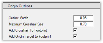

Origin Options
General: An Origin construct defines a visual, physical reference indicating a point from which all other footprint dimensions may be referenced. The Origin construct consists of two independent drafting features forming a crosshair and circle.
Outline Width: user definable as there is no industry standard.
Maximum Crosshair Size: defines the maximum length of a crosshair line (plus the outline width). As a footprint shrinks, the crosshair size is reduced in proportion to the courtyard.
Add Crosshair to Footprint: When checked allows an origin crosshair to be added to a footprint.
Add Target to Footprint: When checked allows an origin target to be added to a footprint.

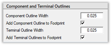

Component and Terminal Options
General: Component and terminal outlines are always shown in the nominal material condition. This is done to maintain a consistent relationship that prevents confusing overlapping outlines that would occur with mixed material conditions.
Component Outline Width: User definable.
Add To Footprint: When checked, allows the nominal component body outline to be added to a footprint.
Terminal Outline Width: User definable. This feature is used for visibility of the terminal lead on the pad. If the terminal lead is not 100% on the pad, there is something wrong with the dimensions.
Add To Footprint: When checked, the nominal terminal outlines to be added to the footprint.

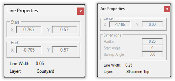

Drafting Element Properties
General: Right-clicking on any of the drafting items will open a dialog box, appropriate to the selected item, displaying its characteristics for viewing only.

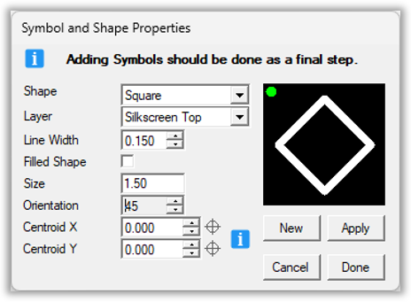

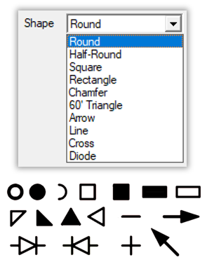

Drafting Symbol Creation
Shape: The following illustrates a variety of available symbol shapes. Shapes can be configured for line width, size, fill, orientation and placement.
Layer: Selects the layer assignment for symbols. Some symbols, such as Diode and Arrow can only be added to silkscreen and assembly layers.
Outline Width: Silkscreen and assembly symbol line width should match the master line widths.
Fill: When checked, creates a solid feature. Fill is not available for diodes or half circles.
Size: This option can be specified in one of three ways: Diameter, for round features; Height and Width, for square and rectangular features; Size for Line, Cross, Chamfer, 60' Triangle and Diode; Base (the arrow base) for Arrow.
Orientation: This option may be specified, with limitations, to some shape types.
Placement X and Y: The X and Y numeric controls may be used to locate or relocate the symbol. Clicking on one of the "target" icons resets the value to zero. The F2 key may be used to capture an X-Y location prior opening the Symbol menu.

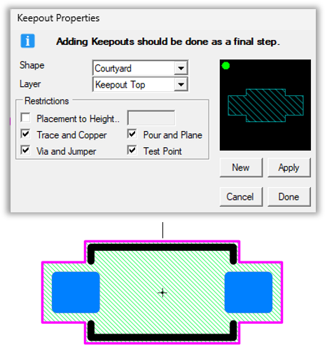

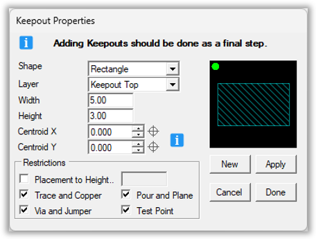

Keep-out Creation
Shape: Basic Keep out available shapes are round, square and rectangular.
A notable exception is the Courtyard option. This option creates a keep out that mirrors the courtyard allowing restrictions that can be applied to the entire footprint.
Layer: Selects the layer assignment for keep outs.
Placement X and Y: The X and Y numeric controls may be used to locate or relocate the keep-out. Clicking on one of the "target" icons resets the value to zero. The F2 key may be used to capture an X-Y location prior opening the Keep-out menu.

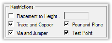

Restrictions: Defines the feature types that will not be allowed within the keep-out area. Placement Height is the maximum allowable height of any object within keep-out area.
