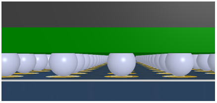

There are Collapsing and Non-collapsing BGA balls.
Collapsing
Non-collapsing

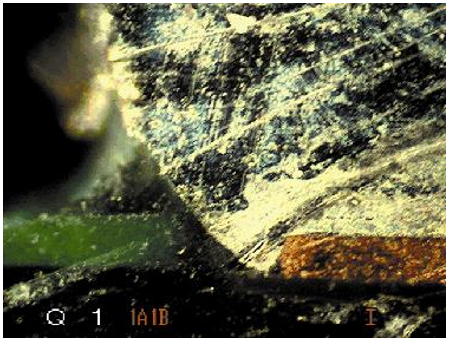

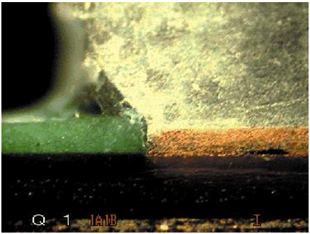

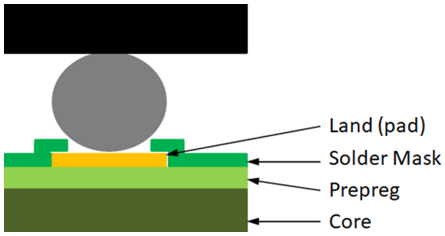

There is also a Solder Mask Defined BGA that has solder mask over the pad edges. The annular ring of the solder mask on pad is typically 0.05 mm. This technology is primarily used to secure the PCB pad to the PCB prepreg in handheld devices like cell phones. During drop tests, the solder joint between the BGA ball and the pad remains intact, but the pad could separate from the prepreg. Solder mask and prepreg are both epoxy resin (glue). The solder mask will help secure the pad to the prepreg to prevent the pad separating from the prepreg. This solder mask defined concept is primarily used on BGA pin pitches of 0.65 mm and lower, where the non-collapsing pad size is larger than the BGA ball diameter.

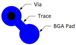

Dog-bone via fanout:
When creating dog bone fanouts for BGAs, the escape trace should be kept as wide and as short as possible. Generally, the trace is a wide as the ball width. A wider trace reduces series inductance, which is critical because the fanout forms part of the high frequency return path loop between the BGA ball, via, and internal plane. Narrow traces behave like inductors at RF, increasing impedance, degrading signal rise time, and injecting noise into adjacent balls.

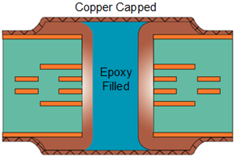

Via-in-Pad technology is a technique used in PCB design where the via is placed directly in the pad. This approach is commonly used in high-density interconnect (HDI) designs, especially for fine pitch BGAs.

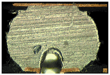

The via-in-pad (VIP) requires a separate fabrication process that includes plating, plugging and capping the hole and planarizing the capped pad to create a flat surface with no dimples. Capped pads with dimples create trapped air under the paste mask. When the PCB goes through the reflow oven, the trapped air in the pad dimple gets super-heated and blows through the solder and into the BGA ball causing a void.
Most of the time the via-in-pad is a microvia that goes from the top layer to the first signal layer. Then buried vias connect to all the other inner layers. All BGA GND connections use microvias to Layer 2. However, PCB fabrication can now drill a hole with a 10:1 aspect ratio. A 1.57 mm thick PCB can support a via hole size of 0.15 mm. But the pad size must be 0.35 to support a 0.10 mm annular ring. This solution is good for 0.40 - 0.65 mm pitch BGAs.

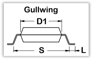

Gullwing
An outward-bent surface mount technology (SMT) lead shape that resembles a seagull's wing in flight. The metal leads extend horizontally from the sides of an integrated circuit (IC) package, bend vertically downward toward the circuit board, and then bend outward again to create a flat mounting foot. This flat foot provides the primary electrical and mechanical contact surface for soldering onto a printed circuit board (PCB) land pad.
Gull wing leads are the dominant terminal style for highly utilized IC packages such as Small Outline Integrated Circuit (SOIC), Thin Small Outline Package (SOP), Quad Flat Package (QFP), Small Outline Transistor (SOT), Ceramic Flat Pack (CFP), Ceramic Quad Flat Pack (CQFP), Small Outline Diode (SOD) and DPAK.

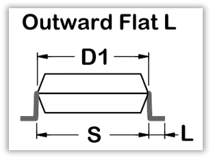

Outward L Lead
Certain small Surface Mount components, such as some SOD’s and SOTs for example, with terminal leads that can be in the form of either Gullwing or Outward flat ‘L’ depending on their dimensions.  It’s important to distinguish between the two to assign the correct protrusion goals (toe, heel and side) to obtain the most reliable footprint mounting. This is how the PCBL Footprint Expert does it.
Gullwing terminals are generally for parts with relatively larger terminals and provide more heel fillet.
Gullwing goals should be applied when:
S min > D1 max    OR    (L max - L min) >= 0 .5mm
Outward Flat L terminals are generally for smaller parts and do not provide as much heel fillet.
Outward Flat L goals should be applied when:
S min <= D1 max    AND    (L max - L min) < 0.50 mm

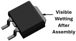

Flat Lug Lead (DPAK Tab)
A large, heat-dissipating backside drain tab of a DPAK (TO-252) surface-mount package into a dedicated flat, surface-mounting contact terminal. It serves as the primary path for drawing destructive heat away from the silicon die and distributes it directly into the copper planes of the printed circuit board. In standard power MOSFETs, this extended tab functions as the high-current electrical connection for the Drain terminal. Avoid applying a 1:1 ratio of solder paste to the flat lug pad area. Industry guidelines from manufacturers like onsemi recommend a windowpane or checkerboard stencil pattern covering roughly 60% of the tab area. This prevents component floating, misalignment, or "tombstoning" from excess solder. The Nominal Toe value is 0.35 mm and must have visible wetting after assembly. The Side and Heel values are very small and set to 0.03 to maintain alignment and prevent skewing. However, some voltage regulator DPAK devices produce additional heat and the manufacturer recommended pattern for the thermal pad size should be taken into consideration. To maximize heat transfer from the flat lug lead, stitch multiple thermal vias into the pad connecting to inner or bottom-layer ground/power planes. Due to the massive heat-sinking nature of the extended tab, hand-soldering requires a large thermal mass iron, a pre-heating hot plate, or a secondary heating source to ensure proper solder flow under the heel of the component.
