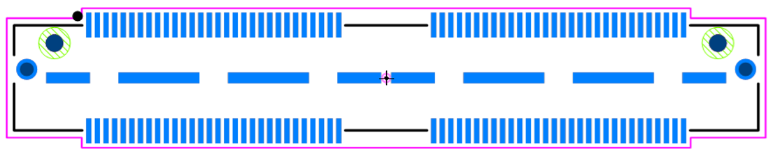

For reference, various unique footprints are shown below that are non-conforming with Tables above.
This is the footprint of SAMTEC_QTH-060-01-L-D-A, an connector with plated mounting and non-plated alignment holes.
