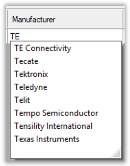

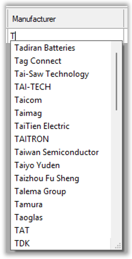

The FPX file has built in features that help automate and organize library data. When you select a Calculator component family and enter the package dimensions and Save to FPX Library, Footprint Expert autogenerates the Footprint Name, Physical Description, Mounting Type, Part Status and Footprint Date. The Manufacturer Names are embedded into the program. When the Manufacturer cell is selected, just enter the first couple letters of the Manufacturer Name and a list of Manufacturers appear in a dropdown menu selection.
By typing a 'T' in the Manufacturer cell, every manufacturer name that begins with 'T' will appear in the dropdown menu.
Type 'TE' and the list will only include manufacturer names that include 'TE'.
Type 'TEX' and the list will only include manufacturer names that include 'TEX'. Texas Instruments is the only manufacturer that begins with TEX. Select Texas Instruments and it will auto-populate the Manufacturer cell.
This will ensure that all the spelling of every manufacturer is consistent.

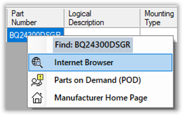

Once the full Part Number is populated, you can Right Mouse Click that cell and a dropdown menu will appear with these options:
When 'Internet Browser' is selected, the default web browser will display all the websites that support that Part Number.
When 'Parts on Demand (POD)' is selected, the default browser will open www.pcblibraries.com/POD allowing you to download that part into your /downloads folder. Then you can import the FPX file into your Master Library and create the footprint out to your CAD tool.
When 'Manufacturer Home Page' is selected, the main page to that Manufacturer will open in your default browser., You can copy/paste the part number into the search box to locate the datasheet.

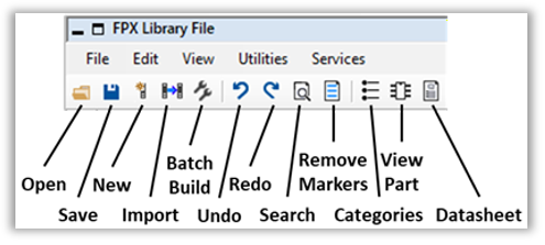

Here are the control features for the Library Editor.
  • Open an existing FPX file library
  • Save the current FPX file (this icon will turn gray when the file is saved)
  • Create a New FPX file
  • Import an FPX file into an existing FPX file
  • Batch Build a selection of parts to CAD tool
  • Unlimited Undo
  • Unlimited Redo
  • Search for text in the FPX library
  • Remove all highlighted Markers
  • Show a list of component family Categories
  • View the selected footprint
  • Open the Datasheet
