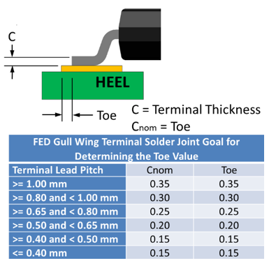

Heel and Toe Goals: IPC guidelines dictate robust calculation values for the Toe (outer edge) and Heel (inner edge) of the pad. These parameters ensure that the solder fillet achieves high mechanical joint strength.
Side Goal Omission: For many molded body components - specifically those utilizing Inward L-Bends - IPC standards omit a side-joint goal requirement. Adding extra pad width along the sides does not increase mechanical hold. Furthermore, excess side solder can cause the component to float or rotate out of alignment during the reflow oven cycle.

Engineering Design Parameters: When laying out a footprint for a molded body part with Footprint Expert use distinct math models.
  • Molded Body Side Goal: Footprint generation tools use a unique variable known as the "Molded Body Side Goal" to ensure the copper landing pads extend far enough beyond the side boundaries of the plastic block, keeping the solder joint from bridging or starving.
  • Heel Fillet Compensation (Jh): Because molded leads often tuck close or underneath the plastic shell, the heel fillet calculations must account for package chamfering to prevent cold solder joints or component tilt.
  • Robust Placement Courtyard: Since the molding process can incur minor edge tolerances (+/-0.2 mm package deviations), the IPC placement courtyard boundary must be generous enough to account for physical variations during automated assembly pick-and-place tracking.

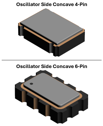

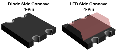

Side Concave Packages 2-pin
Side Concave Packages: A surface mount electronic component housing where the electrical terminations or leads are recessed into indented, semicircular, or "scalloped" channels along the vertical sidewalls of the component body. Unlike standard convex component packages where leads protrude outward (like Gullwing leads) or flat surfaces, the concave architecture places the solderable terminals inside these inner grooves.
Assembly and Manufacturing Impact
  • Solder Joint Integrity: Early designs favored concave configurations under the assumption that isolating the paste within the inner channel would mitigate solder bridging. Modern automated optical inspection (AOI) data shows that the absolute spacing on the PCB pad layout dictates bridging protection far more than the concave shape itself.
  • No-Lead Visual Inspection: Certain modern variations of side concave packages overlap with side-wettable flanks seen in Dual Flat No-Lead (DFN) configurations. This recess allows solder paste to travel upward into the side groove, creating a visible fillet that validates a solid mechanical bond during high-speed assembly inspection.

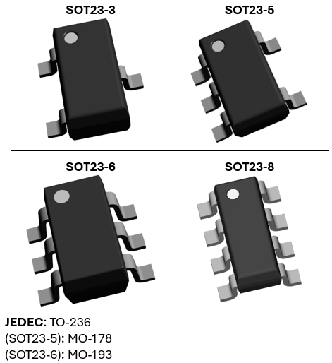

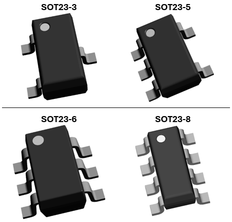

Small Outline Transistor SOT23 (SOT Form Factor)
Small Outline Transistor SOT23 (SOT Form Factor): A highly popular, compact, plastic-molded surface mount device (SMD) package. Widely used for diodes, BJT transistors, MOSFETs, and voltage regulators, it features Gullwing leads extending from its two long sides and is favored for its space efficiency in modern electronics. Typically, 3 pins, though 5-pin (SOT23-5) and 6-pin (SOT23-6) variants are heavily used for small logic ICs and operational amplifiers. Because SOT-23 packages lack a dedicated thermal pad underneath, heat must be dissipated through the copper traces on the PCB. To optimize cooling, expand the copper connected to the pins (particularly the wider drain or collector pin).
JEDEC: TO-236; (SOT23-5): MO-178; (SOT23-6): MO-193
Gullwing SOT23 Type Form Factor Component Families
EIA
JEITA
Pin Pitch
Pin Qty
SOT23-3
SC59
0.95
3
SOT28
SC70-8
0.65
8
SOT323
SC70
0.65
3
SOT346
SC59A
0.95
3
SOT353
SC88A
0.65
5
SOT363
SC88
0.65
6
SOT416
SC75
0.50
3
SOT753
SC74A
0.95
5

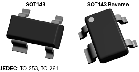

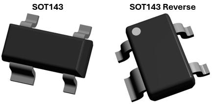

Small Outline Transistor SOT143 (SOT)
Small Outline Transistor SOT143 (SOT): A low-profile, plastic surface mount package featuring four Gullwing leads. Derived directly from the standard SOT-23 geometry, it is uniquely characterized by having one lead that is visibly wider than the other three. This asymmetrical pin layout enforces a built-in reverse-polarity protection, making it a staple for high-frequency radio frequency (RF) transistors, Schottky/PIN diodes, TVS protection arrays, and voltage supervisor circuits.
JEDEC: TO-253, TO-261
PCB Design & Footprint Guidelines
  • Orientation Verification: Because of the asymmetrical fourth lead, CAD footprint library creation must map exactly to the manufacturer's pinout. The wider pad acts as an un-cloneable indicator for automatic vision-inspection and pick-and-place indexing.
  • RF Grounding & Thermal Benefits: The broadened lead is not just a layout guide; it dramatically drops package inductance. This provides an exceptionally clean ground path for RF designs. Furthermore, it serves as the package’s primary thermal conduit to the board, so pulling a substantial copper pour out from this wide pad is recommended.
  • Solder Bridging Risk: Although the side-to-side pitch is spacious, the end-to-end clearance requires exact solder mask dam tracking to prevent solder bridging across the small gaps

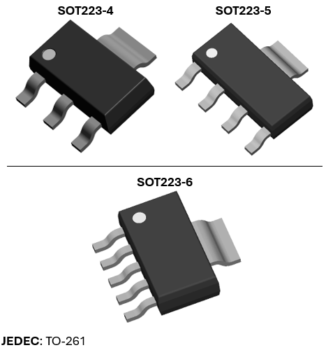

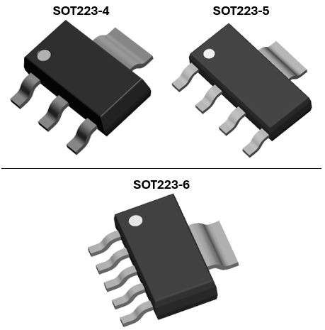

Small Outline Transistor SOT223 (SOT)
Small Outline Transistor SOT223 (SOT): A medium-power, plastic surface mount device package. It is widely chosen for discrete semiconductors and integrated circuits that require robust thermal handling in a compact layout, such as linear voltage regulators, power MOSFETs, and load switches.
JEDEC: TO-261
Key Physical Characteristics
  • Lead Configuration: It typically features four leads total: three standard Gullwing pins on one side of the body and one large, exposed tab on the opposite side.
  • The Thermal Tab: The large tab is mechanically and electrically continuous with the center pin (Pin 2). It provides a direct, low-resistance thermal path to conduct heat away from the silicon die into the PCB.
  • Body Dimensions: The main plastic body measures roughly 6.50 mm x 3.50 mm with an overall profile height of 1.65 mm. Including the leads, the total width span is approximately 7.00 mm.
  • Pin Pitch: The distance between the centers of the three adjacent pins is 2.30 mm for 4-pin and 1.50 mm for 5-pin and 1.27 for 6-pin.
PCB Footprint & Layout Guidelines
  • Thermal Management & Copper Pour: Because the package dissipates more power than smaller standard packages like the SOT-23, its performance relies heavily on your PCB layout.
    • Connect a large copper pour directly to the pad of the large thermal tab.
    • Drop a matrix of thermal vias into the tab pad to transfer heat to internal or bottom-side ground/power planes. Without adequate copper area, the component will overheat and trigger thermal throttling or fail prematurely.
  • Electrical Isolation Considerations: The large tab is typically tied to a specific net (often Vout or GND), depending on the component). Ensure that neighboring signal traces or component pads maintain safe electrical clearance from the enlarged copper pour surrounding this tab pad.
  • Soldering and Solder Mask: Because the pin pitch is a relatively wide 2.30 mm, the package is highly forgiving for both automated assembly line reflow ovens and manual prototyping hand-soldering. However, ensure your footprint includes a precise solder mask cutout for the thermal tab to prevent solder pooling from shifting the smaller pins out of alignment during reflow.

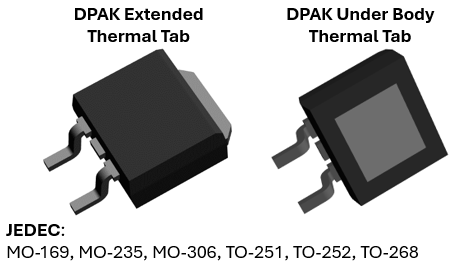

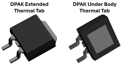

DPAK
DPAK: A standard surface mount transistor package designed for high-power semiconductor devices. It features a large metal tab that solders directly to the PCB to dissipate heat. It is widely used for voltage regulators, MOSFETs, and power diodes.
JEDEC: MO-169, MO-235, MO-306, TO-251, TO-252, TO-268
Key Physical Features
  • Thermal Tab: A large metal backside tab acting as the primary drain/collector connection and heat sink.
  • Three-Terminal Layout: Typically features two smaller leads and one large clipped lead or tab.
  • Surface Mount Design: Eliminates the need for through-holes, speeding up automated assembly.
Design Parameters
  • Lead Pitch: Standard distance between the smaller pins is 2.30 mm (0.090 inches).
  • Thermal Vias: Footprints require an array of vias under the tab to transfer heat to internal copper layers.
  • Solder Paste Stencil: The large tab pad requires a windowpane stencil pattern to prevent component floating and solder splattering.
Performance Advantages
  • High Power Handling: Safely manages higher currents and voltages than standard small-outline packages.
  • Low Thermal Resistance: Direct copper-to-copper bonding ensures rapid heat transfer away from the silicon die.
  • Robust Mechanics: The large soldered surface area provides high mechanical stability against vibration.
Manufacturer Recommended Pattern
Component manufacturers do not provide a reference dimension that links their recommended pattern to the physical package. You can create the pattern in the CAD tool, but you cannot accurately add the drafting outlines for silkscreen, assembly, component, terminal, and courtyard without a reference dimension between the physical package and the recommended solder pattern.

Oscillator, Side Concave (OSCSC)
Oscillator, Side Concave (OSCSC): A standardized, surface mount ceramic or plastic packaging format for quartz crystal oscillators and clock generators. It features castellated solder pads recessed into the flat side edges of the component's body rather than the corners. This design offers a compact, leadless layout that optimizes trace routing and signal path isolation.
  • Side Castellations (Concave Terminals): Semi-cylindrical, metallized grooves are located along the long or short side edges of the rectangular housing. Solder wicks up these inner vertical channels during reflow.
  • Leadless Profile: The absence of protruding metal pins eliminates the risk of bent leads, providing a completely flat underside seating plane.
  • Hermetically Sealed Substrate: Constructed with a rugged ceramic body and a metal lid to protect the internal quartz or MEMS resonator from mechanical stress and moisture.
IPC Footprint & Design Parameters
According to IPC-7351B package standards, the naming format follows OSCSC + Length × Width × Height - Pin Count:
  • Pad Geometry: PCB land pads are positioned flush with the side walls of the oscillator. Pads must extend outward slightly past the package edge to allow a visible side solder fillet to form.
  • Signal Isolation: Placing pads on the sides keeps the component corners clear, allowing routing traces or ground shield fills to pass cleanly around the corners of the component body.
  • Pin 1 Orientation: Because the pads sit mid-side, the package corners are ideal for clear silkscreen dots or chamfered edges to mark Pin 1.
  • Minimized Parasitic Inductance: Short, leadless contact paths minimize inductive loops, ensuring stable performance for high-frequency clock signals.
  • Side-Fillet Optical Inspection: Solder wicks into the side concave channels, allowing easy verification of a robust joint via Automated Optical Inspection (AOI).
  • Self-Alignment: Surface tension from molten solder draws the side castellations symmetrically onto the PCB land pads, reducing component rotation or shifting during reflow.
  • Board Space Efficiency: Offers a very tight, low-profile footprint ideal for dense hardware layouts like telecommunication modules, networking cards, and single-board computers.
Side Concave (4-Pin) Diode and LED
Side Concave (4-Pin) Diode and LED: A specialized, leadless surface mount footprint standard defined by IPC-7351. Instead of utilizing standard peripheral leads or bottom pads, this package features four metallized semi-cylindrical cutouts (castellated grooves) recessed symmetrically into the side walls of its ceramic or epoxy body. It is primarily implemented for multi-diode arrays and multi-color RGB LEDs, where vertical board profile, trace isolation, and optical inspection are paramount.
  • Side-Wall Castellations: The electrical contacts curve upward along the vertical perimeter, creating a concave indentation on the left and right sides.
  • Low-Profile Leadless Structure: Eliminating outward-facing pins lowers the package clearance, saving surface space and preventing accidental lead bending or damage during automatic component picking.
  • Polarized Geometries: Components utilize an uneven chamfered corner, a molded notch, or an offset keyway pin configuration to denote diode cathode placement and prevent reverse assembly orientation.
Common Electrical Configurations
Because this package format breakout provides four distinct terminal points, it typically services two component families:
  • Multi-Color (RGB) LEDs: Houses a shared internal node alongside separate color dies. Semicustom variants break out as either a Common Anode configuration (one positive terminal, three separate color cathodes) or a Common Cathode configuration.
  • Integrated Diode Bridges / Arrays: Integrates a series of four independent rectifier diodes or protection Zeners mapped in a single network (e.g., standard full-wave bridge rectifier or multi-channel ESD clamping array).
Footprint & PCB Layout Parameters
When defining this component footprint inside CAD suites like Altium Designer or IPC Footprint Expert, engineering rules mandate precise layout specs:
  • Pad Extension (Toe Out): PCB land copper must extend beyond the physical side walls of the device housing. This ensures molten solder paste wicks upward into the semicircular channel, generating a visible heel fillet.
  • Solder Mask Openings: Footprints require Non-Solder Mask Defined (NSMD) clearances around the side terminals to prevent masking material from encroaching into the castellated pocket, which could cause cold-joint connectivity failure.
  • Clearance Routing: By keeping the outer corners of the rectangular component body free of metallic terminals, designers can safely route signal traces or drop ground via anchors right up against the corners of the housing envelope without risk of short-circuiting.
  • Robust Optical Inspection (AOI): Automated optical cameras can easily view the solder fillet ascending the vertical side channel from a top-down or slight-angle camera perspective, an option missing from under-body LGA packages.
  • Self-Centering Properties: During the reflow oven process, liquid surface tension pulling on all four concave pockets naturally realigns the chip center directly onto the target pads, reducing rotational skewing or floating.
  • Low Parasitic Loop Inductance: Shorter internal lead pathways significantly minimize high-frequency parasitics, allowing protection diodes to react to high-speed transients rapidly.

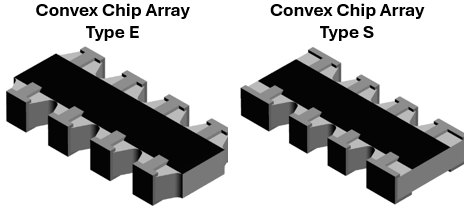

Convex Chip Array
Convex Chip Array: A surface mount passive component housing that integrates a matrix of multiple discrete components (most commonly resistors) into a single leadless chip utilizing outward-protruding (convex) terminal pads. Unlike side concave chip arrays that feature semi-cylindrical recessed scallops, a convex array features smooth, bumps or lobes that extend outward beyond the main ceramic body line. It is the most ubiquitous, standard design format for high-volume resistor networks, digital bus pull-ups, and parallel damping terminations.
  • Outward-Bending (Convex) Leads: The individual terminations are 5-sided blocks that bulge slightly outward from the chip side walls, optimizing contact area.
  • Larger Corner Terminations: For most industry-standard convex packages, the four outermost corner pads are manufactured physically wider than the inner terminal pairs to anchor the component securely.
  • Monolithic Ceramic Structure: Built on a shared high-purity alumina ceramic base substrate. Multiple independent resistive element paths are laser-trimmed and covered under a protective epoxy overcoat glass layer.
  • Pin Formats: Symmetrically split along opposite long sides, most frequently deployed in 4-pin (2-element), 8-pin (4-element), or 16-pin (8-element) packages.
Footprint & Naming Parameters
Footprint parameters, convex packages follow a strict naming structure to properly generate standard library footprints:
  • Standard Prefixes: Uses CRAC (Capacitor Array, Convex) or RESC (Resistor Array, Convex) followed by pitch and dimensions:
    • RESCAX + Pin Count + P Pitch _ Length x Width x Height + L Lead Width x Lead Length.
    • Example: RESCAXS10P64_330X210X70L45X35
  • Asymmetrical Solder Pads: Because the component corner pins are wider than the inner pins, the CAD footprint must feature custom, wider corner pads relative to the inner pairs. Switching a PCB layout from a concave part to a convex part always mandates a solder pad re-spin.
  • Standard Spacing (Pitch): Typically engineered on a precise 0.50 mm or 0.80 mm center-to-center lead pitch to align perfectly with automated SMT placement grids.

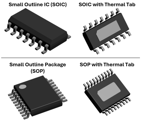

Small Outline Package (SOP/SOIC)
Small Outline Package (SOIC/SOP): A rectangular plastic body with Gullwing leads extending outward from its two longer sides. It originally replaced bulky through-hole DIP (Dual In-line Package) components by shrinking the footprint area and vertical height by up to 70%.
SOP JEDEC: MO-117, MO-118, MO-142, MO-152, MO-153, MO-180, MO-182, MO-230, MO-249, MO-271
SOIC JEDEC: MO-046, MO-059, MO-099, MO-119, MO-120, MO-132, MO-135, MO-137, MO-150, MO-154, MO-164, MO-174, MS-012, MS-013, MS-024, MS-025
  • Gullwing Leads: Metal pins extend out from the long edges of the package and bend downward and outward, forming a shape like a gull's wing.
  • Dual-Sided Pinout: Terminations are arranged symmetrically on opposite sides of the component body, typically numbering from 8 pins up to 64 pins.
  • Plastic Encapsulated Body: Standard configurations utilize a rugged, flame-retardant molded epoxy resin to insulate the internal silicon die.
  • Pin 1 Identification: A chamfered (beveled) edge on the body, a deep notch at one end, or a laser-etched dot indicates Pin 1 location.
Body Width Variations: SOIC packages are categorized primarily by their body width (measured across the plastic body, excluding the leads). Using the wrong width in your footprint design will prevent the component legs from touching the copper pads:
  • Narrow Body (3.90 mm): Commonly used for lower pin counts, such as 8-pin, 14-pin, and 16-pin devices (e.g., standard logic gates, op-amps).
  • Wide Body (7.50 mm): Typically used for higher pin counts or high-voltage chips, such as 20-pin, 24-pin, and 28-pin devices (e.g., microcontrollers, transceiver chips).
Standard small outline footprints follow the naming format:
  • SOIC or SOP + Pin Count + P Pitch _ Body Length x Lead-Span x Height + L Lead Width x Lead Length
  • (where Lead-Span is the tip-to-tip distance across the extended legs).
  • Example: SOP24P50_650X640X120L60X22
  • SOIC Standard Pin Pitch: The center-to-center distance between adjacent pins is universally standardized at 1.27 mm. This was the original SO package in the 1980s.
  • SOP Standard Pin Pitch: The center-to-center distance between adjacent pins is universally standardized at 0.80 mm, 0.65 mm, 0.50 mm and 0.40 mm
  • Pad Extension (Toe, Heel, and Side): PCB landing pads must extend beyond the physical footprint of the Gullwing tip to allow a prominent solder meniscus to climb the outer face of the lead.
  • Thermal Pad Variant (SOIC-EP): High-power variations include an Exposed Pad (EP) on the underside. This bottom pad requires a large ground-plane copper pad on the PCB filled with thermal vias to conduct heat away.
Performance & Manufacturing Advantages
  • High Reflow Reliability: The mechanical flexibility of Gullwing leads acts as a suspension system, absorbing board flexing and CTE (thermal expansion) stresses without fracturing the solder joints.
  • Straightforward Inspection & Repair: Because the pins protrude completely outside the component body, solder joints are 100% visible to standard Automated Optical Inspection (AOI) and can be easily hand-soldered or reworked with a standard soldering iron.
  • Excellent Automated Handling: The flat top surface and rigid, widely spaced pins make it ideal for vacuum pick-and-place nozzles, ensuring fast assembly speeds and low rejection rates.

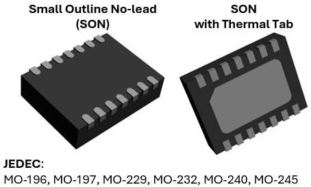

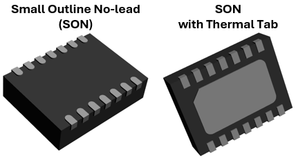

Small Outline No-lead (SON)
Small Outline No-lead (SON): A highly compact, low-profile plastic surface mount integrated circuit (IC) package characterized by the absence of traditional protruding Gullwing or J-shaped leads. Instead, electrical contacts are established via metallized terminal pads located on the underside perimeter, completely flush with the bottom surface of the component body. Because contacts are arranged exclusively along two opposite parallel edges, it differentiates itself from the four-sided Quad Flat No-lead (QFN) format. It is also widely designated across the semiconductor industry as a Dual Flat No-lead (DFN) package by some component manufacturers.
JEDEC: MO-196, MO-197, MO-229, MO-232, MO-240, MO-245
Key Mechanical & Technical Specifications
  • Fine Lead Pitch: Typically standardized at narrow spacings ranging from 0.40 mm to 0.50 mm, though variants expand up to 0.90 mm.
  • Ultra-Thin Profile: Standard seated heights average around 0.85 mm, with ultra-thin configurations shrinking down to a mere 0.35 mm.
  • Pin Density: Commonly deployed for smaller pin-count components, scaling tightly from 4 to 72 pins in specialized rows.
  • Thermal Enhancements: Usually incorporates a large central Exposed Pad (EP) on the package base to function as a primary heat sink.
Performance & Structural Advantages
  • Superior Thermal Dissipation: The central exposed copper die-pad is soldered directly onto the PCB’s thermal land. This eliminates the thermal barrier of encapsulated plastic, letting heat flow seamlessly through plated thermal vias into internal PCB ground planes.
  • High-Frequency Electrical Signal Integrity: Eliminating long, external lead wires massively lowers parasitic inductance, resistance, and capacitance. Consequently, SON components demonstrate clean signal performance, making them ideal for high-speed RF, wireless, and power conversion applications.
  • Drastic Space Savings: By pulling the terminal contacts entirely under the body, the required PCB footprint shrinks significantly compared to standard SOICs. This yields high-density component clustering on complex boards.
Critical PCB Footprint & Design Guidelines: Designing a footprint for fine-pitch SON packages demands strict attention to assembly tolerances:
  • Solder Joint Filleting: Extend the copper land pads 0.40 mm to 0.50 mm beyond the package body perimeter (toe length). This provides proper solder paste wetting and allows for automatic optical inspection (AOI) verification.
  • Bridging Prevention: For standard 0.50 mm pitch devices, restrict the PCB pad width to 0.28 mm or narrower. This guarantees that a solder mask web can fit safely between individual pads, preventing manufacturing shorts.
  • Thermal Pad Segmentation: Avoid pasting a giant solid block of solder over the center exposed pad. Split the stencil aperture into a segmented grid pattern (covering 40% to 80% total area). This lets volatile flux gases escape during reflow, preventing the component from lifting or creating excessive voiding.

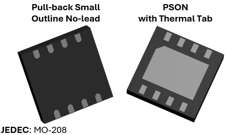

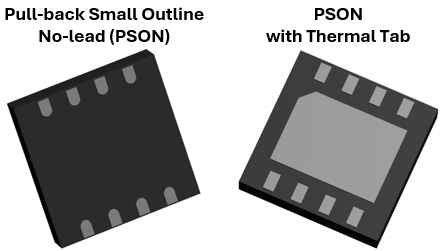

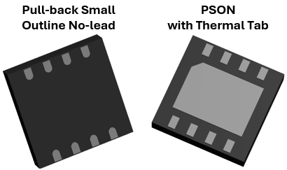

Pull-back Small Outline No-lead (PSON)
Pull-back Small Outline No-lead (PSON): A highly specialized variant of the standard Small Outline No-lead (SON) footprint where the metallized terminal pads are deliberately recessed (pulled back) away from the outer edges of the plastic mold body. Because the electrical contacts do not reach the side walls of the IC, the molded plastic encapsulation completely encloses the outer perimeter. This structural design maximizes board routing space, reduces the risk of accidental electrical shorting, and eliminates visible external solder fillets. Component manufacturers frequently label this package family as PSON or Plastic Small Outline No-lead.
JEDEC: MO-209, MO-252
The "Pull-back" Mechanism Explained: In a standard SON or DFN/QFN package, the copper lead-frame terminal pads are cut during the singulation process, leaving exposed raw copper edges on the sides of the chip. In contrast, a PSON package pulls the terminal ends inward.
  • Recess Distance (Pull-back): Terminal pads are typically shifted inward by 0.075 mm to 0.15 mm from the nominal package outline.
  • Lead Pitch: Maintained at standard fine-pitch intervals of 0.50 mm or 0.65 mm.
  • Low Profile: Height dimensions mirror thin variants, frequently standardizing around 0.75 mm to 0.85 mm.
  • Thermal Interface: Incorporates a large central exposed die pad to ensure low thermal resistance.
Architectural Benefits & Engineering Trade-offs
  • Creepage and Clearance Advantages: By burying the conductive terminal pads underneath the insulating plastic body, PSON packages drastically improve creepage and clearance distances between adjacent traces on high-density layouts. This makes them popular for compact power management ICs (PMICs) and low-voltage switching regulators.
  • Reduced Perimeter Footprint: Because the pads do not extend to the edge, PCB designers can bring peripheral components, ground fills, or trace routing closer to the IC boundary without violating safety clearances.
  • Inspection Challenges (The Solder Fillet Trade-off): During surface mount technology (SMT) reflow, the hidden pads prevent the formation of an external side solder fillet. Because there is no visible side wetting, Automatic Optical Inspection (AOI) systems cannot verify the joint integrity by looking at the perimeter. Electronics manufacturers must rely on Automated X-Ray Inspection (AXI) to guarantee that the hidden pads are properly wetted.
PCB Design & Stencil Requirements: Creating a reliable footprint configuration for a PSON package requires specific modifications to your IPC-compliant CAD library:
  • Pad Inward Extension: Unlike standard SON packages where pads extend outward to form a toe fillet, PSON footprints require the copper pads to expand slightly inward toward the center thermal pad to guarantee sufficient contact area.
  • Solder Mask Webbing: Due to the pulled-back contacts, maintain a strict solder-mask-defined (SMD) or non-solder-mask-defined (NSMD) trace boundary based on the manufacturer datasheet to prevent molten paste from migrating out from under the chip.
  • Aperture Design: Stencils should use a reduced thickness (typically 0.125 mm) with trapezoidal laser-cut walls to maximize paste release on the small, recessed footprints.

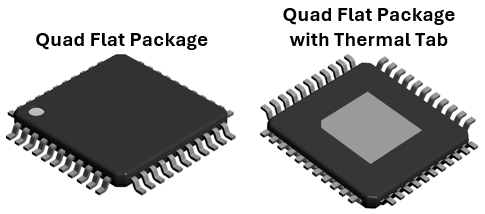

Quad Flat Package (QFP)
Quad Flat Package (QFP): A square or rectangular surface mount integrated circuit (IC) package featuring Gullwing (L-shaped) leads extending outward from all four perimeter edges. This design allows it to accommodate much higher pin counts than two-sided packages like SOIC or SOJ. The QFP serves as a critical bridge between low-pin-count small outline packages and complex ball grid arrays. It became the global industry standard for housing microcontrollers, digital signal processors (DSPs), and application-specific integrated circuits (ASICs) throughout consumer electronics, automotive modules, and industrial hardware.
JEDEC: MO-071, MO-082, MO-084A, MO-108, MO-112, MO-173, MO-198, MO-212, MS-022, MS-029
JEDEC (with thermal): MO-114, MO-189, MO-204, MS-026
  • Lead Pitch: Typically ranges from fine to ultra-fine pitches, spanning 0.40 mm, 0.50 mm, 0.65 mm, 0.80 mm.
  • Pin Counts: Highly scalable, commonly ranging from 32 pins up to 200+ pins.
  • Component manufacturer Body Profiles: Package thicknesses vary widely across component manufacturers. However, the standard footprint name prefix for all these variations is QFP.
    • LQFP (Low-Profile QFP): Standardized at a fixed body thickness of 1.60 mm.
    • TQFP (Thin QFP): Slimmed down to a maximum body thickness of 1.20 mm.
    • VTQFP (Very Thin QFP): Maximum body thickness of 0.80 mm.
    • PQFP (Plastic QFP): Older, thicker variants ranging from 2.00 mm to 3.40 mm, often featuring protective bumper corners.
Core Engineering & Assembly Advantages
  • Exceptional Solder Joint Inspectability: Because the Gullwing leads flare outward away from the plastic package body, every single solder connection is completely visible from above. This allows high-speed Automatic Optical Inspection (AOI) systems or manual inspectors to verify heel and toe wetting fillets easily without requiring expensive X-ray imaging.
  • High Interconnect Density: Distributing interconnect pins along all four edges significantly decreases the required PCB surface area compared to dual-side leaded packages. This allows dense, multi-channel microcontrollers to fit onto compact circuit boards.
  • Compliance and Stress Absorption: The mechanical "S" or "L" bend in each Gullwing lead acts as a microscopic spring. When the underlying PCB expands, contracts, or flexes due to thermal changes and mechanical vibrations, the leads absorb the stress to prevent the solder joints from cracking.
Structural Variations
To meet expanding power and thickness constraints, the QFP design has evolved into several specialized configurations:
  • HQFP (Heat-sink QFP): Integrates a metal heat spreader or an exposed copper pad on the top or bottom surface to dissipate thermal energy from high-power chips.
  • CQFP (Ceramic QFP): Replaces the plastic compound with a hermetically sealed ceramic body for extreme aerospace, defense, and high-reliability deep-space environments.
PCB Footprint & Design Constraints: Designing a reliable footprint for fine-pitch QFPs requires tight layout tolerances to prevent manufacturing defects:
  • Solder Bridging Prevention: For fine pitches (0.40 - 0.50 mm), the copper pads must be narrow (typically 0.22 mm to 0.28 mm wide). This leaves a safe gap for a solder mask dam (web) between adjacent pads to prevent molten paste from bridging during reflow.
  • Toe and Heel Fillets: The PCB Toe Fillet should be 100% the nominal height of the terminal lead and the Pad Heel should be the distance from the Terminal Heel to the nominal package body to give the solder paste room to form proper structural fillets.
Coplanarity Sensitivity: Because QFP leads are thin and extend outward, they are easily bent during shipping or manual handling. If a single lead is lifted out of alignment by more than 0.08 mm to 0.10 mm, it will fail to touch the solder paste pad, resulting in an open circuit.

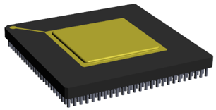

Ceramic Quad Flat Package (CQFP)
Ceramic Quad Flat Package (CQFP): A Premium, hermetically sealed surface mount integrated circuit (IC) package designed specifically for aerospace, defense, deep-space, and high-reliability industrial applications. It features flat ribbon or Gullwing leads extending from all four perimeter edges of a high-purity ceramic body. By combining the four-sided, high-pin-count architectural layout of a standard Plastic Quad Flat Package (QFP) with the absolute environmental immunity of co-fired ceramic materials, the CQFP functions as the industry-standard housing for space-grade FPGAs, high-speed microprocessors, and complex digital signal processors (DSPs).
JEDEC: MO-081, MO-090, MO-104, MO-111, MO-125
  • Hermetic Material: Constructed from multilayer aluminum oxide or aluminum nitride ceramic, sealed with a gold-tin (AuSn) eutectic alloy or glass-frit weld.
  • Lead Pitch: Typically standardized at fine-pitch spacings of 0.635 mm or 1.27 mm to handle high routing densities.
  • Pin Counts: Highly scalable to support complex silicon architecture, commonly ranging from 68 pins up to 352+ pins.
  • Lead Delivery State: Frequently shipped in a "flat" unformed state protected by a metal tie-bar matrix. Assembly facilities trim the tie-bar and bend the ribbon leads into customized Gullwing shapes just prior to PCB placement.
Critical Engineering & Performance Advantages
  • Absolute Hermeticity: Unlike standard plastic packages that slowly absorb atmospheric moisture over time, the CQFP's ceramic-to-metal seals form an absolute gas-tight barrier. This prevents moisture ingress, eliminating internal corrosion, wire-bond degradation, and the destructive "popcorning" effect during rapid thermal transitions.
  • Radiation Hardening Support: Space environments present intense cosmic and solar radiation fields that degrade standard commercial silicon. The dense ceramic composition and heavy gold plating of CQFP housings provide an inherent layer of physical shielding against alpha particles and electromagnetic interference (EMI).
  • Coefficient of Thermal Expansion (CTE) Matching: The CTE of aluminum oxide ceramic closely matches advanced substrate materials like polyimide-glass, metal-core boards, or copper-invar-copper (CIC) cores. This parity minimizes structural shear stress on the solder joints when aerospace modules undergo extreme temperature cycling from 65° C in orbit to +150° C during atmospheric re-entry.
  • Exceptional Thermal Dissipation: High-pin-count CQFPs frequently integrate a massive metal or ceramic base plate (exposed pad) on either the top or bottom surface. Soldering or mechanically clamping this pad to a dedicated PCB thermal plane drastically reduces junction-to-case thermal resistance.
PCB Design & Specialized Assembly Rules: Due to the strict quality demands of aerospace standards (such as NASA-STD-8739.3 or MIL-STD-883), laying out a footprint and assembling a CQFP requires rigorous process controls:
  • Tie-Bar Trimming & Lead Forming: Unformed flat ribbon leads must be processed using ultra-precise, automated tool dies to create uniform Gullwing configurations. Manual bending is prohibited in high-reliability workflows, as minor variations compromise lead coplanarity and induce micro-cracks in the lead plating.
  • Toe, Heel, and Side Fillet Validation: Footprint target pads must extend significantly past the formed lead boundaries (the toe is equal to the terminal lead thickness, and the Heel is equal to the terminal heel to the nominal package edge). This allows the solder paste to form distinct, highly visible fillets required for strict visual inspection without automated X-ray dependency.
  • Mechanical Tie-Downs and Underfills: Because ceramic bodies are heavy, intense launch vibrations can snap thin copper traces or crack solder joints. Space-grade layouts often dictate the application of specialized silicone or epoxy underfills beneath the component body to decouple mechanical G-forces from the electrical contacts.

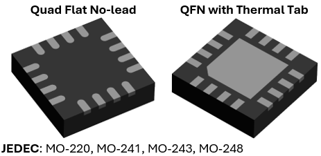

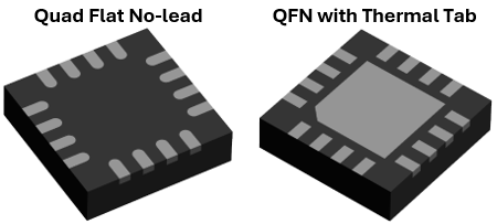

Quad Flat No-lead (QFN): A highly popular, low-profile surface mount integrated circuit (IC) package characterized by a square plastic body with no protruding lead wires. Instead, it utilizes metallized terminal pads arranged along all four edges of its underside perimeter, completely flush with the bottom surface of the component. It is the four-sided counterpart to the Small Outline No-lead (SON) package and is widely favored for modern smartphones, consumer electronics, and high-frequency RF modules due to its miniature footprint and excellent electrical characteristics.
JEDEC: MO-220, MO-241, MO-243, MO-248
  • Fine Lead Pitch: Standardized at tight sub-millimeter intervals, most commonly 0.40 mm, 0.50 mm, 0.65 mm and 0.80 mm.
  • Ultra-Low Profile: Seated package heights are exceptionally slim, typically ranging from 0.75 mm down to 0.40 mm.
  • Pin Counts: Highly scalable for small-to-medium logic circuits, ranging from 8 pins up to 100+ pins.
  • Thermal Core: Features a prominent central Exposed Pad (EP) on the underside to facilitate direct thermal and electrical grounding.
Core Engineering & Performance Advantages
  • Minimal Parasitic Inductance: By eliminating long, external Gullwing or J-shaped leads, the internal wire bonds or flip-chip bumps connect almost directly to the PCB copper. This short path drastically reduces parasitic inductance, resistance, and capacitance, allowing QFNs to operate cleanly in high-speed digital and high-frequency RF applications.
  • High-Efficiency Thermal Path: The central exposed metal die pad is designed to be soldered directly to the board's copper plane. This configuration allows heat generated by the silicon die to bypass the plastic encapsulation completely, transferring directly into internal PCB copper layers via plated thermal vias.
  • Substantial PCB Space Savings: Because the contacts are pulled entirely underneath the perimeter of the component body, a QFN consumes up to 60% less board area and 30% less height than an equivalent leaded package like a Quad Flat Pack (QFP).
PCB Footprint & Manufacturing Challenges: Designing an IPC-7351 compliant footprint for a fine-pitch QFN package requires balancing compact spacing with assembly reliability:
  • The Solder Fillet Dilemma (Toe Fillets): QFN lead-frames are typically cut during factory singulation, leaving raw, unplated copper exposed on the outer sides of the chip. This exposed copper oxidizes rapidly. During reflow, solder paste will wet the bottom pad perfectly but may fail to climb up the outer side wall. Because there is no reliable side fillet, Automatic Optical Inspection (AOI) systems struggle to verify joint quality, often necessitating Automated X-Ray Inspection (AXI).
  • Wettable Flanks (An Assembly Fix): To solve the AOI issue, many modern QFNs feature a step-cut or plated cavity on the outer edge called a Wettable Flank. This manufacturing process keeps the outer edge of the pad plated with gold or tin, forcing the solder paste to form a visible vertical fillet that standard AOI cameras can easily verify.
  • Thermal Paste Segmentation: To prevent the component from floating or tilting during reflow, the solder paste stencil aperture over the large center pad must not be a single giant opening. Designers must divide the center stencil aperture into a segmented matrix grid (covering 50% to 75% of the area) to let volatile flux gases escape without creating massive solder voids.
  • Solder Mask Dams: For ultra-fine pitches (≤ 0.50 mm), the space between individual perimeter pads is incredibly narrow. Maintain a strict pad-to-mask clearance boundary to ensure the PCB fabricator can successfully place an insulating solder mask web between the pads, preventing solder bridging.
