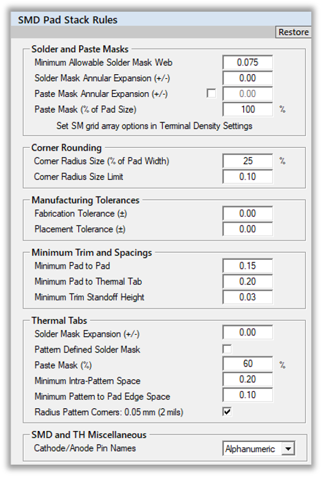

Pad Stack Rules will globally define the rules for every footprint created in the Surface Mount Calculators. These rules are not used for custom FP Designer footprints because the user manually defines every pad stack in custom parts. Custom footprints always use the component manufacturer recommended pattern and pad sizes because there are no standard recommendations or guidelines for unique packages and their related footprint patterns. The default values are best known practice, but users can edit any value for their PCB library requirements.

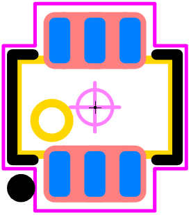

d. Gang Solder Mask
When the Solder Mask Annular Expansion rule is violated, Footprint Expert will automatically Gang Mask the entire row.  This image illustrates an Oblong pad shape Gang Mask
This image illustrates a Rounded Rectangle pad shape with Pin 1 Oblong Gang Mask

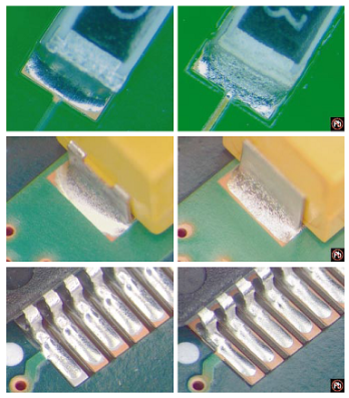

Some people say that rounded rectangle pad shape is best for lead free solder. This is a myth, as all pad shapes are OK with lead free solder. IPC has recommended Oblong pad shape since the release of IPC-SM-782 in March 1987. The 782 Standard had both text and graphic illustrations. The text referred to Oblong (or Full Radius) pad shape but the images portrayed Rectangle Pad Shape. This was confusing to the reader of the Standard. Most component manufacturers recommended patterns for surface mount parts illustrate Rectangular pad shape. The Rounded Rectangle Pad Shape is a compromise between the world standard Oblong and the component manufacturer Rectangle. Also, it is important to note that paste mask stencil aperture openings are laser cut with rounded corners. It makes sense to have the pad shape match the paste mask stencil aperture shape.
When the PCB goes through a reflow oven, the paste mask tends to gravitate toward the terminal lead and away from the pad corners. It doesn't make sense to have rectangular pad shapes with no solder in the pad corners. Here is a photo of both lead and lead-free solder with no solder in the corners.

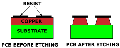

Manufacturing tolerances have existed in the IPC mathematical model for surface mount pad size calculation since 1987. The Fabrication Tolerance was used to compensate for the etching process. But in the 1990's, the fabrication shops started to swell the outer layers to compensate for their etch back tolerances so that they could deliver pad sizes and trace widths the same size as the original Gerber data. But there is also an issue with the subtractive process where the etch acid gets slightly under the photo resist and creates a trapezoidal effect in the trace and pad. IPC-7351 uses a 0.05 mm fabrication value in the pad size math to compensate for this subtractive process. The average copper thickness on the outer layers is ½ oz. or 0.017 mm. The acid under photo resist undercut value is only a small percentage of that. Basically, the Fabrication Tolerance added to the pad size calculation is no longer applicable.

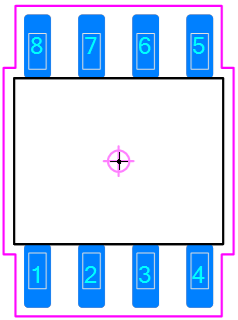

a. Minimum Pad to Pad - 0.15

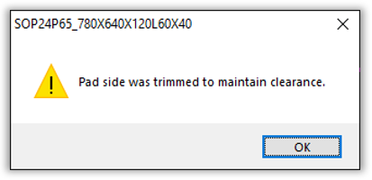

The minimum pad to pad rule is intended for surface mounted pad stacks. When the minimum pad to pad spacing violates this rule, Footprint Expert will automatically trim the pad to enforce this rule and an error message will be created that looks like this:
The value of 0.15 is arbitrary and not a hard-coded standard. The minimum pad to pad spacing rule should never violate your minimum PCB clearance rule. If your PCB layout uses a minimum trace/space rule of 0.20 mm then you should set the minimum pad to pad rule to 0.20.
If you want to ensure a 0.08 minimum solder mask web and your solder mask annular expansion is 0.05 then change the minimum pad to pad value to 0.18. This guarantees a solder mask web between every SMD pad. If the minimum pad to pad is 0.15 and the pads violate that rule, the Gang Mask feature will kick in and mask the entire row.

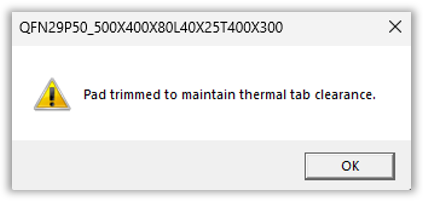

b. Minimum Pad to Thermal Tab - 0.20
The minimum pad to thermal rule is primarily established by most component manufacturer's recommended patterns and not any industry Standard. If the thermal pad is too big and violates this rule, the pads (not the thermal pad) will be trimmed, and a warning message will be created that looks like this:

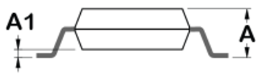

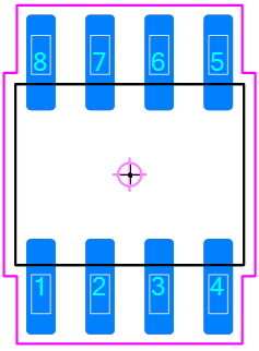

c. Minimum Trim Standoff Height - 0.03
The minimum stand-off is the A1 package bottom to PCB space dimension in gull wing packages.
The default "minimum" value of 0.03 mm will only trim pad Heel under the component package if the A1 value is less than 0.03. The main purpose for pad trimming under low profile packages is to eliminate paste mask from touching the plastic body during reflow. The pad Heel is an important part of the gull wing solder joint, but if the Heel pad is under a low-profile package, the solder on the pad Heel is pushed out by the weight of the package creating excess solder.
IPC-J-STD-001 mentions in table 7-7 Dimensional Criteria - Flat Gullwing Leads. Note 4: Solder should not extend under the body of surface mount components whose leads are made of Alloy 42 or similar metals.
Note 1: this rule was created because it was assumed that pads under low profile packages could potentially cause solder-bridging under the component body and invisible to visual inspection. However, there are no known reported cases of solder bridging under low profile packages when the pad extends under the package body. Therefore, the minimum A1 stand-off rule can be safely turned off to 0.00. This rule mostly affects the SOT23 and the 50-mil pitch SOIC component families.
Note 2: the average SOIC terminal lead length is 0.84 with tolerance of +/-0.43 or minimum 0.41 and maximum 1.27. The resulting IPC solder pattern must accommodate the minimum, nominal and maximum tolerance. This extends the pad under the component package by 0.55. However, the average SOIC package stand-off is 0.10, so the A1 stand-off of 0.03 is not violated and the pads will not trim.

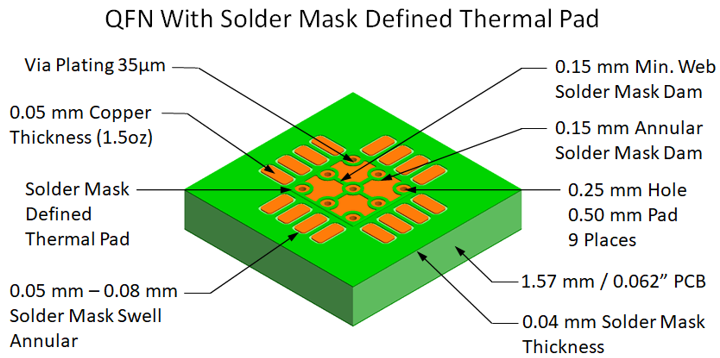

b. Pattern Defined Solder Mask - on/off check box

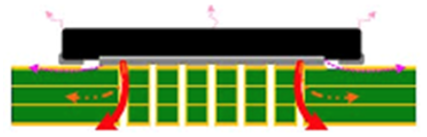

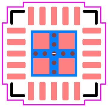

The default setting for this feature is turned off because the user must accept the responsibility for turning it on. The solder mask defined thermal pad places solder mask in-between the paste mask apertures, basically damming in the paste mask from flowing. The IPC-7093A describes all the benefits of this feature.
Ability to add vias in the solder mask area and the paste mask will not flow down the via hole. This could potentially save on fabrication costs to avoid via plugging to stop the flow of paste mask into the via hole.
This image provides some basic values for defining a solder mask defined thermal pad.

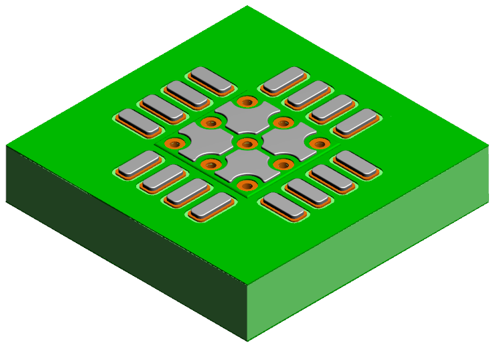

This image illustrates a 0.10 mm paste mask stencil thickness for the image above.

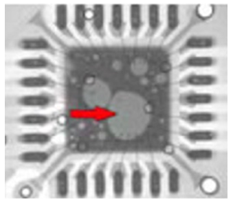

Because the paste mask is dammed in by solder mask, this reduces paste mask voiding because the solder has nowhere to flow. The amount of voiding post reflow should not exceed 25% per IPC-A-610. Voiding occurs when the thermal pad is not solder mask defined.

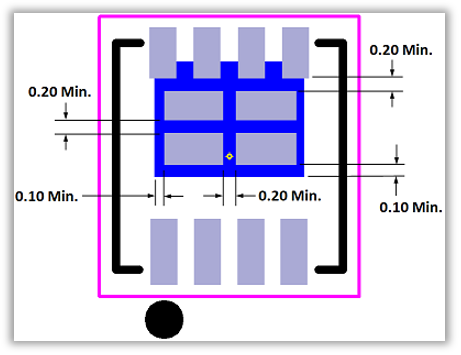

d. Minimum Intra-Pattern Pattern Space - 0.20

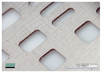

The default setting for this feature is 0.20 mm. It is important to have a minimum stencil aperture spacing to increase the stencil web strength. This will make the stencil last longer and work better.
e. Minimum Pattern to Pad Edge Space - 0.10
The default setting for this feature is 0.10 mm. This setting works OK up to 70% paste mask coverage. If you need 80% paste mask coverage, you will need to set this value to 0.00 to allow paste mask to extend to the edge of the pad. If you keep the 0.10 paste to pad edge and have 80% paste mask coverage, the checkerboard pattern will turn into a single aperture.
If you use the solder mask defined thermal pad feature and intend to place vias in-between the paste mask you need to figure out the via hole size and add 0.10 for the minimum pattern space. Example: if the via hole size is 0.20 + 0.10 clearance for the solder mask web, then the thermal tab minimum pattern space should be set to 0.30. Or you can move the calculator part to FP Designer and edit the pad stack paste mask to set the aperture size and spacing.
Note 1: The Solder Mask and Paste Mask aperture opening are the same size and location.
Note 2: 9 vias provide the maximum thermal relief for most packages with thermal tabs.
