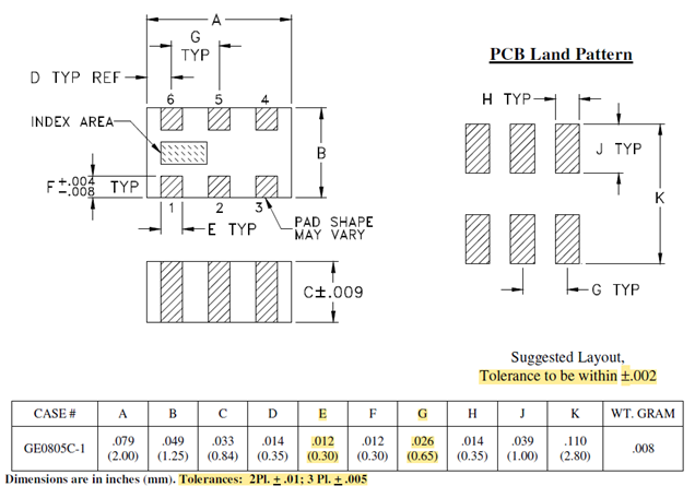

Quote MINI-CIRCUITS has a wide range of RF devices with non-JEDEC/custom package types, e.g. the selected DLFCG-540+ (Case GE0805C-1) 6-pin SMT ceramic filter.
In this case (and for their other components), the part outline has tolerances both on the termination width E (which is normal) and the pitch G (which, I think, is singular). The same G pitch value is used for their PCB land pattern recommendation, with different tolerances. Note - "Suggested Layout Tolerance to be within +/-.002"
Looks weird to me, at least unusual. As far as I know, the component termination pitch has no related tolerances and has often a BSC (Basic Spacing between Centers) mention.

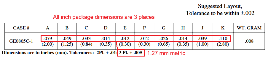

Any package with dimensions like a 0805 package should have a realistic maximum tolerance of 0.15 mm max, 0.10 mm nom. or 0.05 mm minimum. We prefer to use the minimum tolerance of 0.05 because it's realistic.

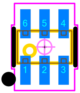

Here is the Mini-Circuits Recommended Pattern using their negative tolerance.
Pad stacks are too way robust for their minimum material condition.

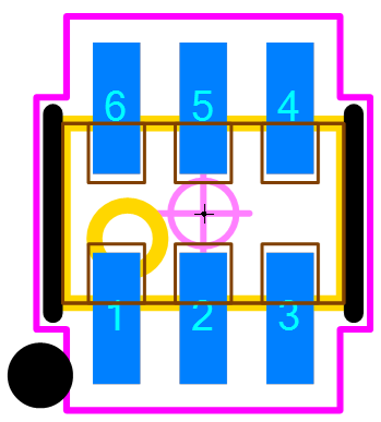

Here is the Mini-Circuits Recommended Pattern using their positive tolerance.
Not sufficient pad stack for maximum material condition.

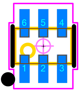

Here is the Mini-Circuits Recommended Pattern using no tolerances.
Perfect pattern for a package using no tolerances.
It looks like Mini-Circuits did not use their own tolerances when they created their Recommended Pattern.
