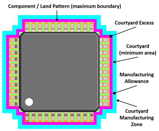

In PCB design, courtyard excess refers to the specific clearance area between the combined physical boundary of a component (body and pads) and the outer boundary of its placement courtyard. This buffer zone ensures that components have sufficient space for manufacturing tolerances, mechanical assembly, and potential rework without interfering with neighboring parts.
Courtyards should not overlap in the part placement. Courtyards are used in a variety of ways in different CAD tools. The courtyard excess values are defined in the 3-Tier density levels for surface mount components.

The default courtyard outline maps to the pads and the Maximum package body dimensions. Mapping the courtyard outline to Maximum package body dimensions is affected by package tolerances. Package tolerances vary between component manufacturers affecting the resulting courtyard excess value. There is a Drafting Option switch to change the courtyard outline to map to the Nominal package body. Using Nominal package body is not affected by package tolerances and provides a consistent courtyard excess for all footprints regardless of the package tolerance values. IPC-7352 only recommends mapping to the Maximum package dimensions, but industry consensus is leaning toward using Nominal package dimensions because component manufacturer tolerances are sometimes too robust and unrealistic.

The courtyard excess for component body and footprint pads can be independently adjusted. The main reason for 2 different settings is because the physical package can move in any direction during reflow oven, but the pads never move. Typically, the courtyard to body and courtyard to pad are set to the same value for symmetry, but they can be adjusted to the individual user.
There is also a manufacturing allowance provided by the assembly shop as a courtyard-to-courtyard clearance rule. In the average case, courtyards can be bumped next to each other. But the assembly shop may provide a spacing rule between courtyards, and this is referred to as the manufacturing zone.
The original courtyard shape in IPC-SM-782 was rectangular. The contour courtyard was introduced in the IPC-7351 guideline. The Footprint Expert can automatically switch between either courtyard outline shape, and rebuild your entire library with whatever you choose.
