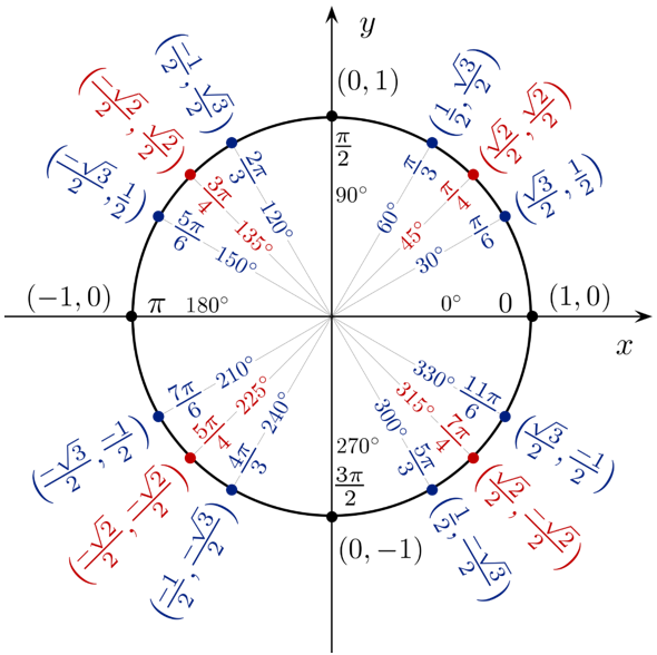

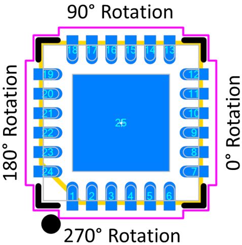

Printed circuit board technology uses geometry to define the rotational angle of every object in the PCB design. Objects use geometry to define the orientation starting at 0,0 which is located on the right center. Cartesian coordinates are also defined per the PCB or Footprint origin. Popular Pad and Footprint rotations are 0, 90, 180 and 270 degrees, but can be placed at any angle. Pad and Footprint orientations start at 0,0 and rotate counterclockwise.
Pad Rotations Start at 0,0 in the Positive X Location
Pad rotation follows geometry standards.
Footprint rotations are in 90° increments starting with the zero-component orientation per the IEC 61188-7 Rotation B released in 2007 with pin 1 in the Lower Left corner. IEC 61188-7 reflects the same zero component orientation documented in the IPC-SM-782 standard that was released in March 1987.

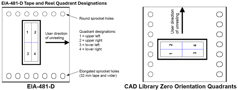

In 2005, IPC-7351 introduced a new Zero Component Orientation with Pin 1 in the Upper Left, redefining pin 1 orientation to the Upper Left, and deviating from an 18-year old standard (1987 - 2005), defining the pin 1 orientation in the lower left. Also, the zero-component orientation should follow the Tape and Reel, Tube and Tray orientations defined by EIA. However, component manufacturer rotations vary from one mfr. to another for the same package type. A standard must be adhered to by component manufacturers.

Per all the JEDEC standard package definitions, quadrant 1 is where pin 1 should be located.
IPC and IEC use consistent rotations throughout their standard where EIA uses multiple rotation variations:
  • IPC-7x51 uses Quadrant 2 for Pin 1 Upper Left and Quadrants 2-4 for Upper Center
  • IEC 61188-7 uses Quadrant 1 for Pin 1 Lower Left and Quadrants 1-2 for Left Center
  • EIA-481-D uses Quadrant 1 for Pin 1 Lower Left BGA, SOIC, SOP, SSOP, QFNR, DIP
  • EIA-481-D uses Quadrant 2 for Pin 1 Upper Left TO-252, TO-263, QFNS, TSSOP
  • EIA-481-D uses Quadrant 3 for Pin 1 Lower Right for all SOT and miniature parts
  • EIA-481-D uses Quadrants 1-2 (Pin 1 Left Center) for PLCC, LCC
None of the 3 standards use Quadrant 4 for Pin 1 location.

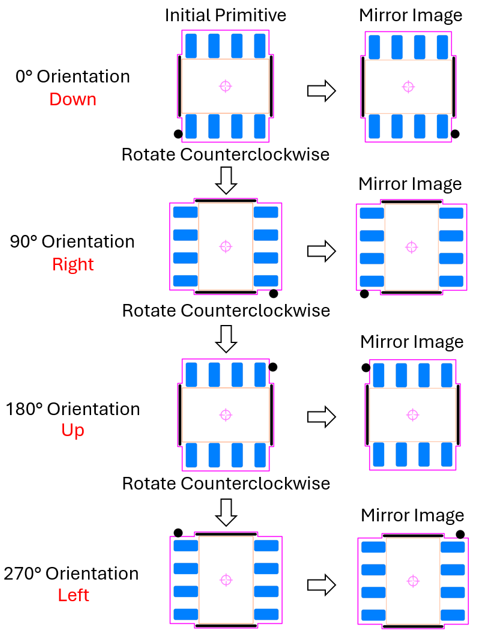

Here is the flow for zero-component orientation and the counterclockwise rotation of a standard 8-pin SOIC.
