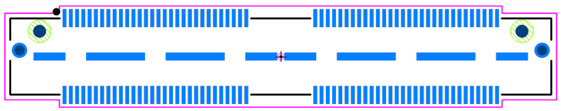

This is the footprint of SAMTEC_QTH-060-01-L-D-A, an connector with plated mounting and non-plated alignment holes.
