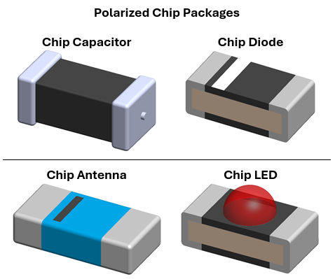

Chips
Chips: An ultra-compact rectangular housing designed specifically for surface mount discrete passive or semiconductor devices containing exactly two electrical terminals. Electrical contacts are located at opposite ends of the body, wrapping around the edges to form metallized soldering pads. Most 2-pin passive chips are physically symmetrical, allowing automated pick-and-place systems to orient them easily without top-to-bottom or front-to-back errors. The body typically consists of a single block of ceramic (for capacitors), thick-film substrate (for resistors), or molded plastic/glass (for diodes).
Monolithic Structure: The body typically consists of a single block of ceramic (for capacitors), thick-film substrate (for resistors), or molded plastic/glass (for diodes).
Rectangular or Square End-Cap Terminations: Electrical contacts are located at opposite ends of the body, wrapping around the edges to form metallized soldering pads.
Symmetrical Design: Most 2-pin passive chips are physically symmetrical, allowing automated pick-and-place systems to orient them easily without top-to-bottom or front-to-back errors.

Performance & Manufacturing Challenges
Tombstoning Risk: Because these chips have only two terminals, an imbalance in surface tension during solder reflow can cause the component to lift off one pad and stand vertically like a tombstone. This is minimized by maintaining perfectly symmetrical landing pads and thermal reliefs.
Ultra-Low Parasitics: The absence of long lead wires reduces parasitic inductance and capacitance, making these packages ideal for high-speed signal integrity and high-frequency RF layouts.
High-Speed Placement: Their flat, symmetrical shapes make them highly optimized for automated vacuum pick-and-place nozzles, allowing assembly machines to shoot thousands of these components per minute.

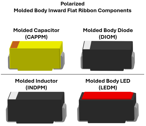

Molded Body
Molded Body: Electronic component housings formed by encapsulating internal elements (such as a silicon die, a capacitor element, or a lead frame) in a solid, injection-molded thermoset plastic or epoxy resin. Unlike generic ceramic or open-frame structures, these packages provide an airtight, structurally rigid shield that safeguards components against moisture, physical impact, and operational vibration.
Inward L-Bend Lead: The leads curl tightly underneath the molded plastic shell. This saves valuable PCB area, though it hides the solder joints from easy optical inspection.
Heel and Toe Goals: IPC guidelines dictate robust calculation values for the Toe (outer edge) and Heel (inner edge) of the pad. These parameters ensure that the solder fillet achieves high mechanical joint strength.
Side Goal Omission: For many molded body components - specifically those utilizing Inward L-Bends - IPC standards omit a side-joint goal requirement. Adding extra pad width along the sides does not increase mechanical hold. Furthermore, excess side solder can cause the component to float or rotate out of alignment during the reflow oven cycle.

Key Physical Features
  • Fully Encapsulated Core: Thermoset epoxy compound forms a solid protective layer on all sides, completely insulating the sensitive inner structures (such as silicon dies, wound wires, or sintered tantalum pellets) from environmental elements.
  • Integrated Polarity Markers: Because the body is formed in an injection-molding process, bevels, chamfered corner notches, or deep laser-etched bands are built directly into the plastic to indicate polarity (essential for diodes and tantalum caps).
  • Wrap-Around or Inward Terminations: Leads typically exit the bottom or centerline of the plastic molding and are bent flat against the body ends or tucked flush as leadless bottom contacts.
  • Classifications & Examples: Molded body packages use unique design rules and prefixes to accurately map their footprint requirements.
Tantalum Capacitors (CAPMP / EIA Standard): Features highly standardized molded packages categorized by standard uppercase lettering.
  • A Case (3216 Metric): 3.20 mm x 1.60 mm nominal
  • B Case (3528 Metric): 3.50 mm x 2.80 mm nominal
  • C Case (6032 Metric): 6.00 mm x 3.20 mm nominal
  • D Case (7343 Metric): 7.30 mm x 4.30 mm nominal
Diodes (DIOM / JEDEC DO-214): Molded discrete diodes leverage robust, wide wrap-around terminal feet built to absorb thermal stress.
  • SMA (DO-214AC): Smallest common molded diode variant
  • SMB (DO-214AA): Medium profile option
  • SMC (DO-214AB): Largest footprint format supporting high power surge ratings
Engineering Design Parameters: When laying out a footprint for a molded body part with Footprint Expert use distinct math models.
  • Molded Body Side Goal: Footprint generation tools use a unique variable known as the "Molded Body Side Goal" to ensure the copper landing pads extend far enough beyond the side boundaries of the plastic block, keeping the solder joint from bridging or starving.
  • Heel Fillet Compensation (Jh): Because molded leads often tuck close or underneath the plastic shell, the heel fillet calculations must account for package chamfering to prevent cold solder joints or component tilt.
  • Robust Placement Courtyard: Since the molding process can incur minor edge tolerances (+/-0.2 mm package deviations), the IPC placement courtyard boundary must be generous enough to account for physical variations during automated assembly pick-and-place tracking.
