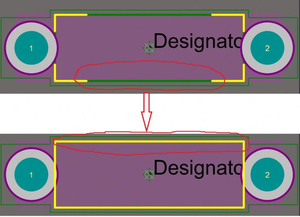

Hello. It happened that we need to reconfigure the current library with the new settings (customer has requested to change the line width of silkscreen). Is it possible to do without building new library?
And couple of questions as well:
1. Is it possible to create symbol which consists only of pins, designator and silkscreen (please see the picture number 1)?

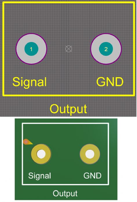

2. How to prolongate the line which represent the through hole resistor silkscreen geometry (please see the picture number 2)?

Post Options Post Options   Thanks (0) Thanks(0)   Quote Tom H Quote  Post ReplyReply Direct Link To This Post Posted: 02 May 2019 at 8:00am
Move the Axial Lead Part to FP Designer and build the other part in FP Designer.
There are 13 videos for all the features in FP Designer in the Library Expert "Help > Topics > Contents" and in the on-line user guide.
