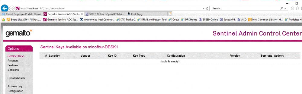

Post Options Post Options   Thanks (0) Thanks(0)   Quote IntelDCG Quote  Post ReplyReply Direct Link To This Post Posted: 30 Apr 2019 at 12:22pm
I get this error however reinstalling LE-E-2019-2 and the Sentinel ACC server software was no help.
I don't think my license server has licenses anymore.
