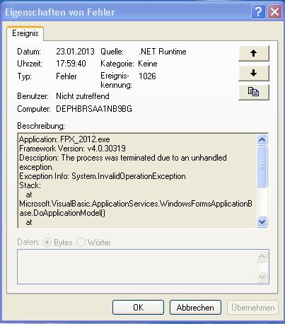

once completed basically the software will not run. this is a message from the validator.
I installed Footprint Expert on two PC’s under WinXP; they don’t run. Sandglas opens and nothing happens.
On a virtual machine under WinXP I installed it also, and it works.
In the Computer Management I found an Error Message.
If I opened the Properties I get the following message. Seems to be Dot.Net. Version 4 is installed.

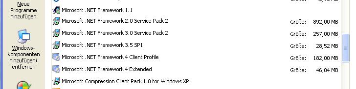

Can you verify you have all these Microsoft .NET installations (Control Panel >> Programs)
Since you're in Germany, the date and size may be a bit different...

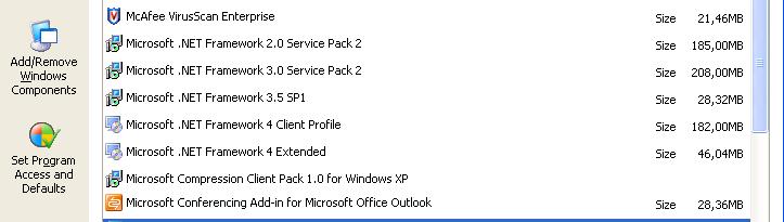

Post Options Post Options   Thanks (0) Thanks(0)   Quote sgdavies Quote  Post ReplyReply Direct Link To This Post Posted: 25 Jan 2013 at 3:32am
Hi Nick,
This is the answer I got from our validator.
Control Panel: WinXP (Virtual Machine-English)) it runs!
Control Panel: WinXP (Desktop-DE) does not run!

I came across a problem in the past (license related), where the license mechanism froze up if it found two certain versions of the Framework. Please try to make the following changes to the Desktop-DE machine so it is identical with the Virtual one that works:
1. Remove .NET Framework 1.1
   Does that make a difference?
   If not you might try to locate the following revisions on Microsoft.com --
2. Uninstall .NET Framework 2.0 SP2 (892MB) and install 2.0/SP2 that is 185MB
3. Uninstall .NET Framework 3.5 SP1 (28.5MB) and install 3.5/SP1 that is 28.3MB
Note, if you select "German" or "English" language setting for download, it will likely make a difference for the size of the Framework.
