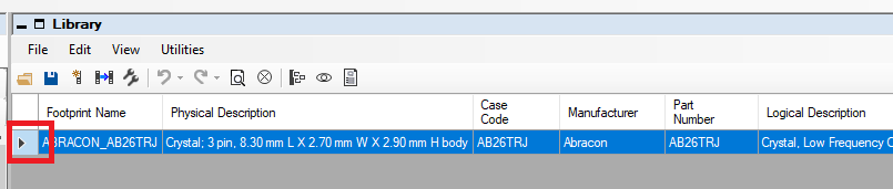

POD Builder users who are upgrading to version 2021, you can only build downloaded/purchased FPX parts by the "Build Selection" method.
1. Right-click row button of part you want to build

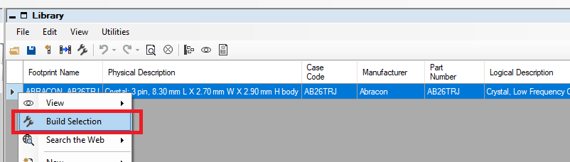

2. Click "Build Selection", then proceed with desired settings.
