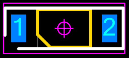

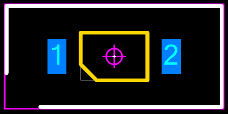

Post Options Post Options   Thanks (1) Thanks(1)   Quote dwaltoneng Quote  Post ReplyReply Direct Link To This Post Posted: 14 Jun 2013 at 3:04pm
It turns out that it is the order that you define pads in that makes the difference. If you define the surface mount pad first, when you place the pad, the courtyard will be adjusted to fit that pad. If you define the large through hole pad before the surface mount pad, when you place the surface mount pad, the courtyard is adjusted as though you placed the through hole pad.
Surface mount pad defined first -
Large through hole pad define first, but not placed

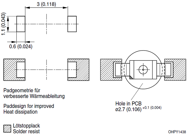

Page 9 of the data sheet http://catalog.osram-os.com/jsp/download.jsp?name=LG_M47K_Pb_free.pdf&url=/media/_en/Graphics/00042011_0.pdf I quoted in my original post does provide body details.
This part is a reverse mounted LED. The entire body of the part sits in a 2.7mm hole.
