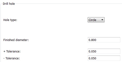

The key here is where do you want the information to come from?
We have a Fabrication Tolerance setting. Is this usable as the allegro padstack tolerance setting? Or do you need something more? Are you looking for each padstack to have a tolerance, or will a global tolerance that you set(i.e. from a cell in the grid) work?

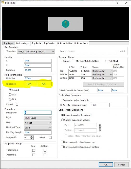

Altium has supported drill tolerances on holes since version 17.1 or possibly earlier. I also would appreciate this feature.

Altium doesn't require a tolerance, so I leave it unset and specify a default tolerance in my fabrication drawings for most holes. I would like if this could remain an option for Altium.
