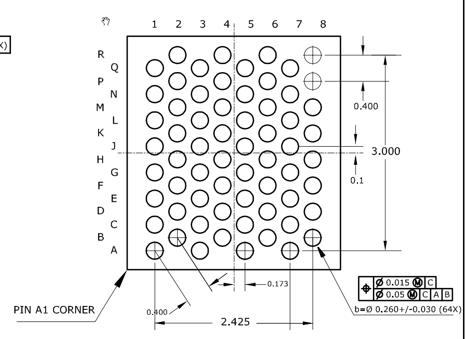

I am trying to use the LE Pro to create a footprint for a part using an WLCSP-64 package.
This has alternating columns of pins offset/staggered.
What do I need to create this footprint and STEP model with the LE Pro?
https://i.imgur.com/UwhkqDG.png

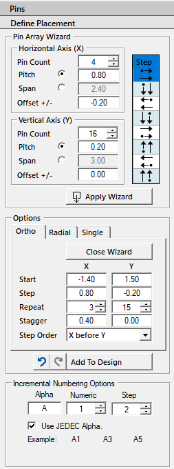

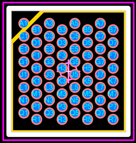

Post Options Post Options   Thanks (0) Thanks(0)   Quote Tom H Quote  Post ReplyReply Direct Link To This Post Posted: 25 Jan 2025 at 12:37pm
V25.03 Footprint Expert.
Here is the FP Designer Wizard settings for this Staggered Pin BGA.
Here is the finished BGA footprint.
