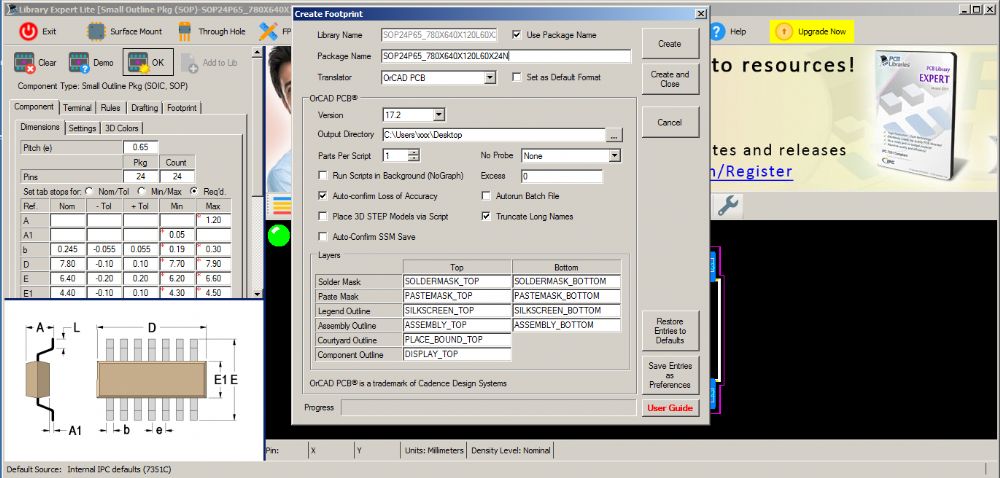

What does your layer mapping look like?
DSchaef View Drop Down
Joined: 17 Jan 2017
Points: 16
Post Options Post Options   Thanks (1) Thanks(1)   Quote DSchaef Quote  Post ReplyReply Direct Link To This Post Posted: 26 Jan 2017 at 6:28am
It's the default mapping:

If you do a search through the main .scr (it'll have the same name as the footprint) for '# Labels' you'll see the section which adds the REF and DEV and it should look like this:
# Labels
Label refdes
setwindow Form.mini
FORM mini text_block 3
FORM mini angle 0
FORM mini mirror NO
FORM mini text_justification Center
FORM mini class REF DES
FORM mini subclass SILKSCREEN_TOP
setwindow pcb
pick 0 0.75
Text "REF"
done
setwindow pcb
Label refdes
setwindow Form.mini
FORM mini angle 0
FORM mini mirror NO
FORM mini subclass ASSEMBLY_TOP
setwindow pcb
pick 0 0.75
Text "REF"
done
setwindow pcb
Label device
setwindow Form.mini
FORM mini angle 0
FORM mini mirror NO
FORM mini class DEVICE TYPE
setwindow pcb
pick 0 0.75
Text "DEV"
done
The big question being why your Ref Des is apparently going to ASSEMBLY_TOP subclass on both, and not SILKSCREEN_TOP on the first. The way its setup you should have a Ref Des on each ASSEMBLY_TOP and SILKSCREEN_TOP, and then the DEV goes only to ASSEMBLY_TOP.
