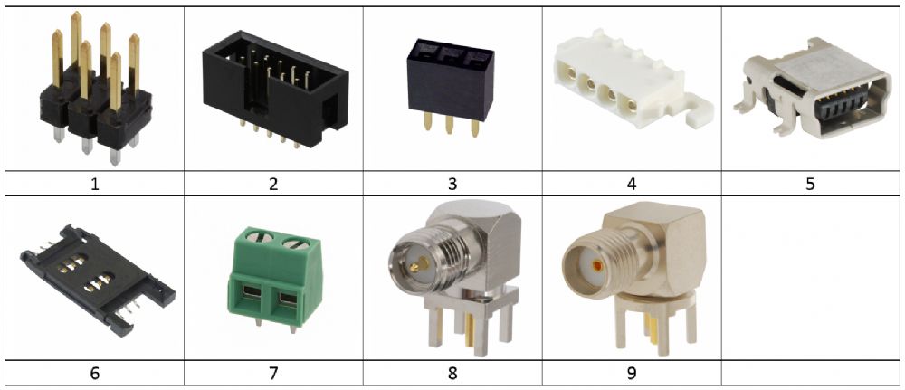

Could anyone please specify what are the correct designators for the following parts?
Some would use J? for all those parts, because they are the least-movable parts of a connector. However, some use, for example, JP? for [1], X? for [2], P? for [3], XP? for [5] and TB? for [7].

Tom, I know that, but it does not make thing very clear to me.
Also,
X = Socket
and hence
XP - Female socket
Tom, so you would use J? for [1], [2] and [8] and P? for all the rest? You would not use X? designator?
I have checked PCB designs from well know companies as TI and Analog, I have also checked provided libraries by connector manufacturers and they all were using different designators for the same type of components. If such big players cannot get it right it is likely not that obvious.

You are correct.
J = 1, 2 & 8
P = all the rest
X = Socket and 99.9% of all sockets are female. I don't know of any socket plugs but there might be one, so I didn't put 100%.

Ok, thank you. Can you please provide any examples (part numbers) where you would use X? designator?
For example, Wago and Phoenix is using X? designator for all their terminal blocks. So they are doing it wrong then...

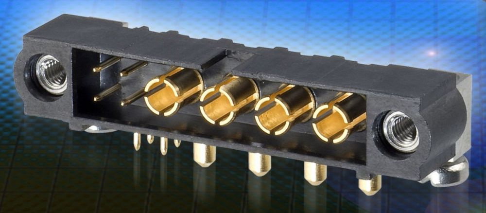

What about this connector, would you suggest using J? or P? designator?
Also, I took a look at what designators are Agilent and Keithley using in their hi-end products. As you can see, they avoid P? and use J? instead.

In the case where the connector has a dual sex, J is used more often.
I've seen EE engineers use J for every connector whether it's Male or Female.
J is far more popular than P.

That multi connector is awkward so I'd go off what the majority is - socket.
