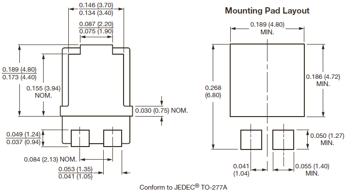

Vishay for example uses for the SS5P6 the TO-277A package, they call this package SMPC
This package is not an Transistor Outline (TO, DPAK) as there are no gull wing leads, nor is it an SOTFL as the lead width is not the same for all leads.
What would be the recommended way to generate such a footprint with Library Expert Pro ?

The JEDEC TO-277A Package is not in the IPC-7351 standard yet.
You can create this footprint in less than 5 minutes in FP Designer.
