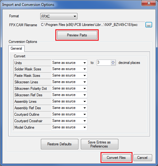

V2014.06 has now been released! http://www.pcblibraries.com/forum/library-expert-201406-released_topic1383.html
I forgot to mention that the FPX file is only library documentation.
If you want to see the part and create the CAD tool footprint you need to run the new FPXC converter which is located in the "Utility Tools > FPXC to CAD" option.
This opens the FPXC filter and you can select the Preview Parts button to view to part.
The filter allows you to change drafting line widths or turn off drafting items.

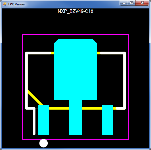

Here is a view of the NXP SOT89 -
