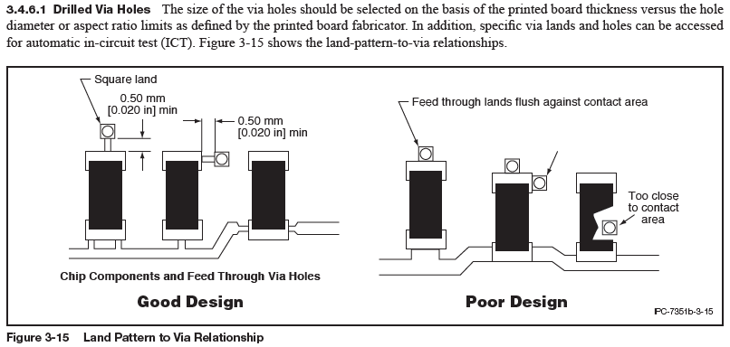

Is it because the IPC-7351B Standard has this illustration?

The question has arisen owing to our PCB tool  (Altium) having it as an optional design check. That and the pad sizes on the smaller components now combined with the worry of heat being sucked out of them. I am, however, reassured by your comment on that.
As an example I am using a TPS2546 and setting a current limit of 2A. With the temperature rise constraints and the layer stack, the trace width required is a minimum 0.35mm. The pad on the device is only 0.26mm wide.
The impedance requirements for the data traces on the same device calls for a trace 0.381mm wide, also going to pads that are also only 0.26mm wide. Consequently some neck down has to occur otherwise adjacent pads get shorted. This also raised the question of "heat sucking" and hence the question of what neck down value should be used.

So the standards themselves recommend necking down.
Then isn't it time the standards were updated and this changed?
TBH I think that this is something that needs considering on a net by net, pad by pad - connection basis. Each joint having it's own requirements i.e. if impedance controlled or if a big fat track going into an 0201 and you use a poor assembler :)
