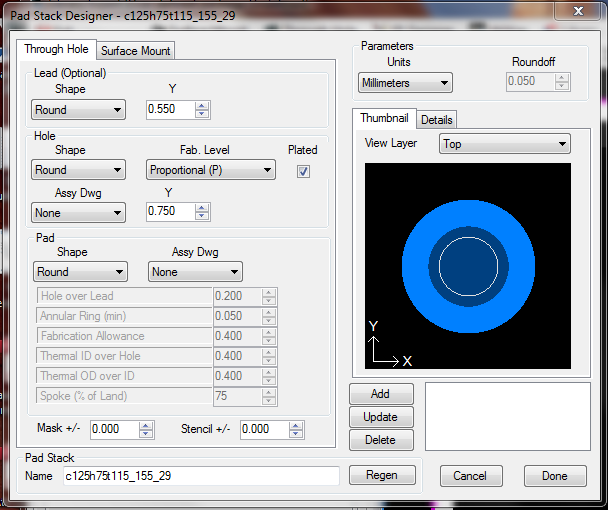

rickdehart View Drop Down
Joined: 18 Apr 2012
Location: Austin, TX
Points: 184
Post Options Post Options   Thanks (0) Thanks(0)   Quote rickdehart Quote  Post ReplyReply Direct Link To This Post Posted: 31 Jul 2013 at 10:12am
The round-off setting is greyed out.  Is there another place to set it?
Points: 499
Post Options Post Options   Thanks (0) Thanks(0)   Quote Jeff.M Quote  Post ReplyReply Direct Link To This Post Posted: 31 Jul 2013 at 5:08pm
Actually, it should reflect the current preference.
Bug fix in progress...
Thanks.
