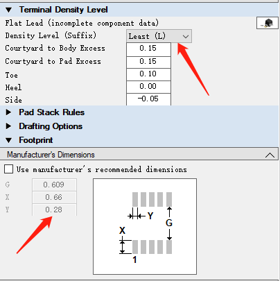

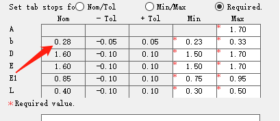

Today, I use the 2021.09 version to generate a SC89 footprint (using the SOFL package). I found the pad size in 'L' density is generated according to the nominal size. Assuming a pin with such width specification:
MIN = 0.23, NOM = 0.28, MAX = 0.33
Then the pad width generated is 0.28. Is it designed like this, or it's a bug?
Thanks.

Yes, I use the default solder joint goals and mfr, etc. The datasheet of the part is https://www.onsemi.com/pdf/datasheet/nta4153n-d.pdf, the SC-89 package.
Points: 6105
Post Options Post Options   Thanks (0) Thanks(0)   Quote Tom H Quote  Post ReplyReply Direct Link To This Post Posted: 07 Jul 2021 at 9:00am
It's perfect. The pad width can not be any smaller than the nominal lead width.

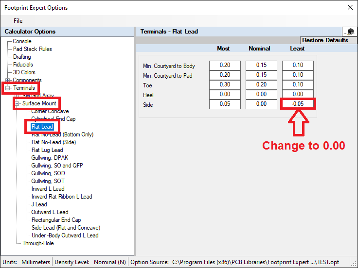

Not in the "Least Density Level".
Least = minimum pad size, but still functional and manufacturable.
Use Nominal Density or change the "Tools > Options > Terminals > Surface Mount > Flat Lead > Least > Side"
You have the controls to create your PCB library.
