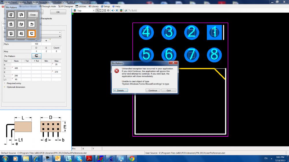

I am not able to select the pin pattern compared to previous "PCB Footprint Expert V2012", only 8 selected pin pattern is available, the rest of the option have been disable and will pop out error if I try to select them.

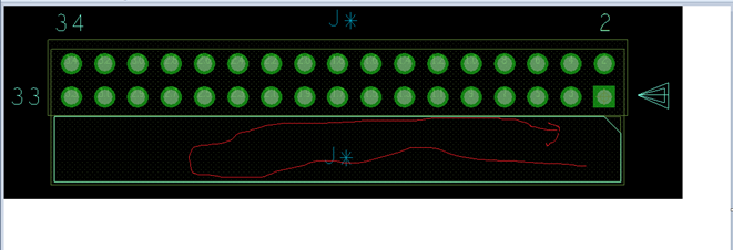

Maybe i am not describe well enough the bugs, I wished to create header that have pin 1 indicator as below and i not able to choose the pin pattern from version 2013.

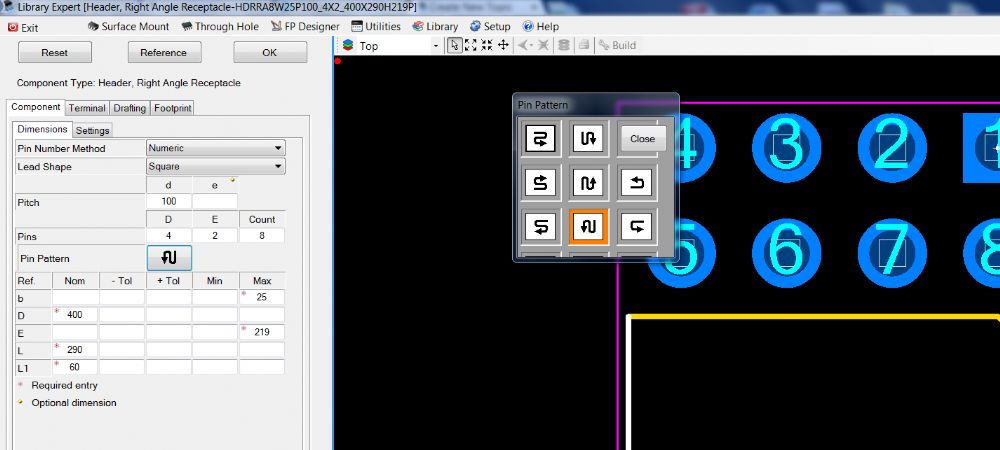

From version 2012's pin pattern (left side), you can see all the pin pattern's option is available:
For version 2013's pin pattern(right side), limited option is available and i not able to stretch the window, force to click the blank option will give me errors as above.

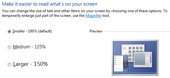

This issue might have to do with "Windows 7" Fonts.

This solves the problem. Thanks.
