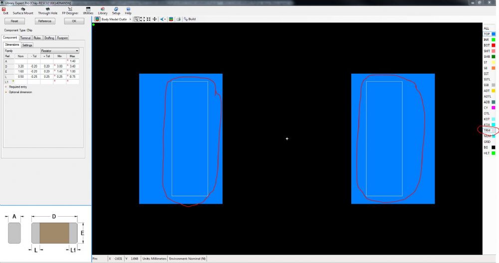

I want to export the Terminals Layer from Library Expert Pro , to Pads.
I have attached an image where i highlight the terminals and the terminals layer tab. On that image only top layer and terminals layer is currently ON.

Post Options Post Options   Thanks (0) Thanks(0)   Quote Tom H Quote  Post ReplyReply Direct Link To This Post Posted: 12 Jun 2014 at 12:09pm
Those outlines are the component terminals.
PADS does not have a layer assignment for component terminals.
What layer would you want them on?

Post Options Post Options   Thanks (0) Thanks(0)   Quote Eng. Jesus Mora Quote  Post ReplyReply Direct Link To This Post Posted: 12 Jun 2014 at 12:16pm
Well it would help us a lot if we could export them on any mechanical layer, eg. mechanical layer 17.
It would not really matter which layer as long as it could be exported to a mechanical layer.

Post Options Post Options   Thanks (0) Thanks(0)   Quote Tom H Quote  Post ReplyReply Direct Link To This Post Posted: 12 Jun 2014 at 12:29pm
PADS Layers 1 - 18 are electrical Layers
Layer 19 is used for Title Blocks or things that appear on all Gerber file.
Layer 20 is the placement Courtyard Layer.
Layers 21 - 30 are pre-assigned Drafting Layers.
There are only 30 layers and they are all accounted for.

Post Options Post Options   Thanks (0) Thanks(0)   Quote Eng. Jesus Mora Quote  Post ReplyReply Direct Link To This Post Posted: 12 Jun 2014 at 12:32pm
So there is no way we can export them? even if we do it on a same layer that is already in use?
thanks
Points: 6105
Post Options Post Options   Thanks (0) Thanks(0)   Quote Tom H Quote  Post ReplyReply Direct Link To This Post Posted: 12 Jun 2014 at 12:47pm
The Library Expert currently only exports footprint data.
We've had requests to also output the component leads on the Assembly Top layer but they don't play any role in the CAD library other than a visual.
Also, there is a feature to turn on/off pads on Assembly to allow the user to selectively add Filled or Outline pads for the assembly drawing.
We will add your request to our next poll for the June Newsletter and see how many users want this feature. The more features we add the more buttons appear in the GUI and things get busy and complex. We're trying to keep things user friendly and simple.
