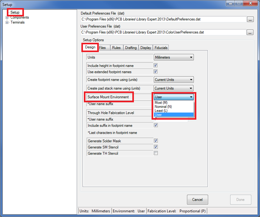

Some people get the User and Default Preferences mixed up.
In "Setup > Preferences > Design" if you select "User" it is a 1-Tier library system.
If you select Least, Nominal or Most it is a 3-Tier library system.

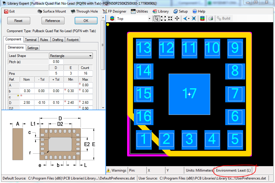

So here's a pic of the part I did - its in the PQFN with Tab Family.  You can see that its set for the Least Env:

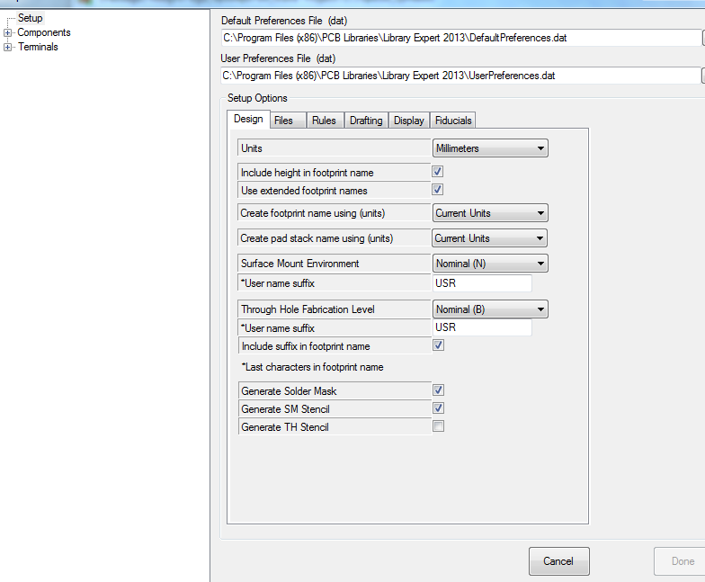

Then I changed the User Default to the Nominal Env - and then said "OK" again - should it update the footprint at that point?  It didnt in this case:

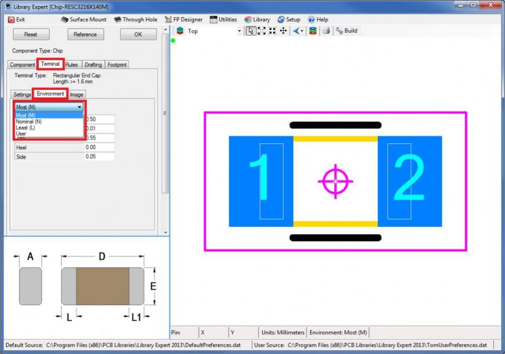

When you are building a single Footprint, you change the environment in the Calculator, not User Preferences. Select the "Terminal > Environment > Dropdown"
But if you change any component dimensions, the preferences will reset to whatever your defaults are set to. Hope this helps.
