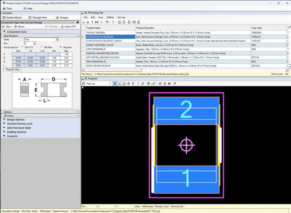

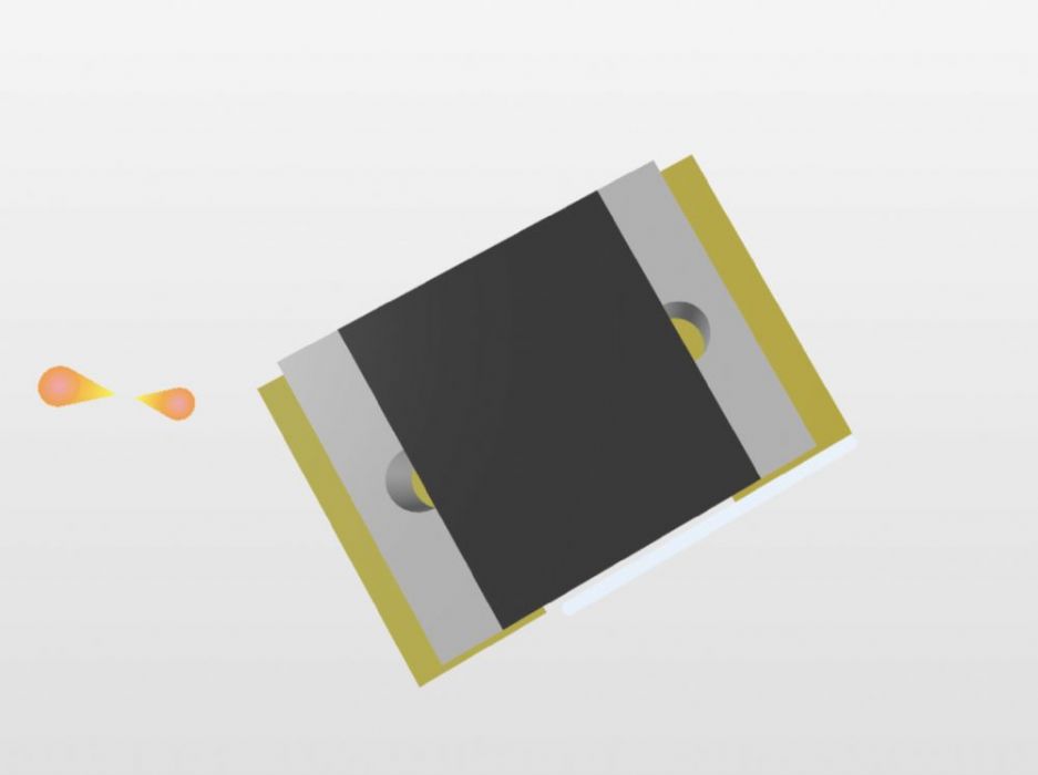

I created a side concave footprint for a fuse. When I export to Altium the 3D symbol looks strange. The concave part is not on the outside?
The Footprint Expert input:

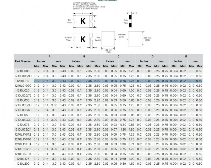

Info datasheet.

Post Options Post Options   Thanks (0) Thanks(0)   Quote Tom H Quote  Post ReplyReply Direct Link To This Post Posted: 21 Nov 2025 at 7:49am
We fixed this in the current V25.12 pre-release - www.pcblibaries.com/downloads ;
Let us know if this works OK for you.
