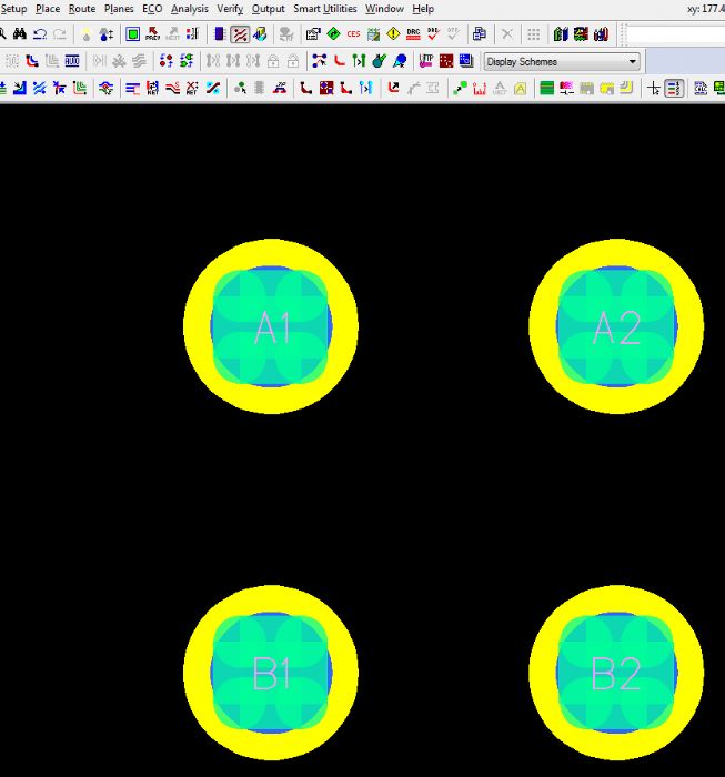

Our DFME suggest to set the solder paste to Round Rectangular shape instead of a round one. The picture below can show the padstack for BGA in our library. The blue round shape is pad and yellow one is solder mask. The Rnd Rec shape in green is solder paste.
