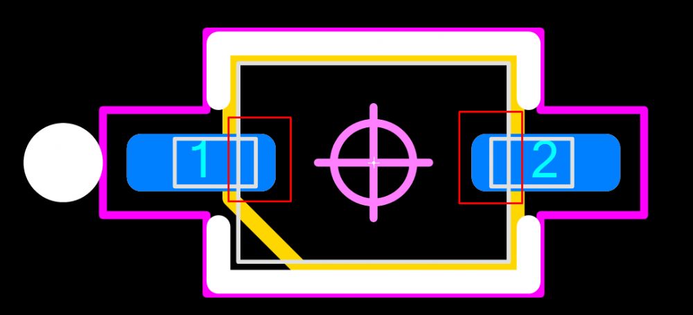

I am coming again with the same idea. I've been working now with a SOD-323F diode from DIODES.
I would like to read your comments, not only Tom and Nick, about what do you think about the idea of modify the radio of the inner corners of the pad or even making them completely squared.
Here my reasoning is similar to thermal tabs, we build them completely squared to fit them perfectly on the pad.
Here I believe that if we decrease the inner radio perhaps we could make the pad even smaller. Now there is an aprox. distance of 0.12mm between the center of inner side of the pin and the center of the inner side of the pad. But this distance is not real because the corners are rounded and if the component is moved this distance to the right or to the left the corners of the pin are going to be outside the pad.
The possibility of this movement is real. There is a lot of space between the pin and the external border of the pad. I believe that could be a reasonable thought.
Looking forward to hearing your comments.
david

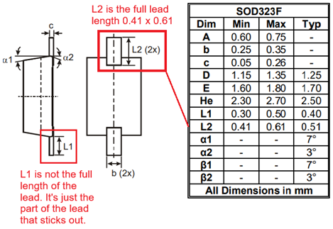

Points: 6098
Post Options Post Options   Thanks (0) Thanks(0)   Quote Tom H Quote  Post ReplyReply Direct Link To This Post Posted: 20 hours 13 minutes ago at 9:03am
The terminal leads for DFN packages are 100% under the package body.
The Diodes SOD323F is in the SODFL component family.
The SODFL terminal leads are under the body and also protrude beyond the package body.

Post Options Post Options   Thanks (0) Thanks(0)   Quote dramos Quote  Post ReplyReply Direct Link To This Post Posted: 15 hours 29 minutes ago at 1:47pm
Thanks for your fast reply!!!
We are in the same page about the type of the diode.
The main difference between both types is that the SOD has Toe, Heel and side values for some density levels.
I would like your idea to mix both on SOD, from the Toe add the solder joint and from the Heel make it completely squared without radio on corners because it is under the body.
Regards,
david
Points: 6098
Post Options Post Options   Thanks (0) Thanks(0)   Quote Tom H Quote  Post ReplyReply Direct Link To This Post Posted: 14 hours 56 minutes ago at 2:20pm
Under body DFN terminal leads have a Periphery pad calculation based on the terminal lead tolerances so that the resulting pad stack can handle the terminal lead in the maximum material condition.
In this case the pad stack would have the same shape as the terminal lead - rectangle.
90% of the solder joint strength is under the Flat Lead. But assembly would like to see visible wetting in the toe for visual inspection.
The Toe, Heel and Side are there to allow the solder under the terminal lead to flow outward during reflow.
All bottom terminal lead pad stacks are slightly larger than the terminal lead to allow the lead to settle into the solder paste during reflow.
Making the pad size the same as the terminal lead size is not recommended. But since the pad stack periphery is slightly larger than the terminal lead, the pad shape needs to be the same as the terminal lead as there is no room for rounded rectangle pad shape without exposing the terminal lead.
