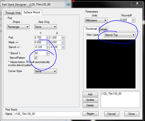

Post Options Post Options   Thanks (1) Thanks(1)   Quote rickdehart Quote  Post ReplyReply Direct Link To This Post Posted: 05 Aug 2013 at 11:56am
Here is a snap shot of the stencil top selected, Stencil % = 50.  I also have the mask set for 0.05 on both X and Y.
I see no stencil reduction indicated in the name.
I see no stencil in the View Layer.
I do see stencil in the Details, but it is not reduced.
Points: 501
Post Options Post Options   Thanks (1) Thanks(1)   Quote Jeff.M Quote  Post ReplyReply Direct Link To This Post Posted: 05 Aug 2013 at 1:33pm
Your'e trying to add a stencil pattern to a pad that is too small for a stencil pattern.
Note the 'Stencil Pattern' check box.
Anything below 70% defaults to a pattern (reserved for thermal tabs).
You need to get up to about 2mm before a thermal tab is recognized.
Uncheck the box and you'll see your stencil.
