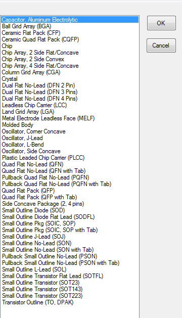

Hello Tom:
I didn't find an option for SMB (DO-214) package in Library Expert Pro. Which item will be used for this type package?
Thanks.

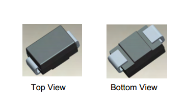

Post Options Post Options   Thanks (0) Thanks(0)   Quote drj-bbe Quote  Post ReplyReply Direct Link To This Post Posted: 04 Aug 2015 at 3:11am
The component shown below.
IanOnBass View Drop Down
Joined: 15 Mar 2012
Location: UK
Points: 99
Post Options Post Options   Thanks (0) Thanks(0)   Quote IanOnBass Quote  Post ReplyReply Direct Link To This Post Posted: 04 Aug 2015 at 3:14am
That's a Molded Body package.
Post Options Post Options   Thanks (0) Thanks(0)   Quote Tom H Quote  Post ReplyReply Direct Link To This Post Posted: 04 Aug 2015 at 5:54am
Yep, that's a Molded Body Diode.
Molded Body has these component families:
  • Capacitor
  • Capacitor, Polarized
  • Diode
  • Diode, Non-polarized
  • Fuse
  • Inductor
  • Inductor, Precision
  • LED
  • Resistor
Get to know your SMD component families. Download this PDF file -
drj-bbe View Drop Down
Joined: 08 Jul 2015
Points: 71
Post Options Post Options   Thanks (0) Thanks(0)   Quote drj-bbe Quote  Post ReplyReply Direct Link To This Post Posted: 04 Aug 2015 at 6:03pm
Thank you, lanOnBass and Tom. I have found Molded Body in the option.
