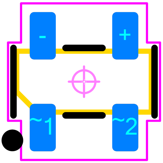

The SOT23 component family is a Gullwing terminal lead and you can renumber pins to whatever you want. You can change the footprint name and physical description to whatever you want.
Here's a gullwing footprint with custom pin names.
