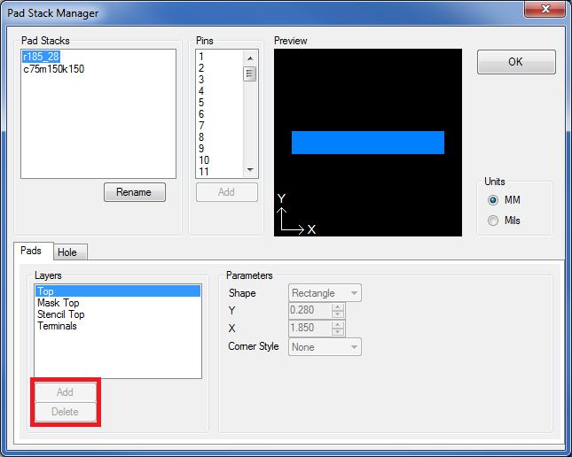

When you select a pad and select "Right Mouse Button / Properties / Pad Stack" this dialog window appears -
The Add / Delete buttons are grayed out, which makes me wonder why they're there.

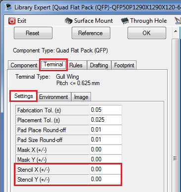

However, you can control the paste mask in the
A "positive value" will make the paste mask larger and a "negative value" will make the paste mask smaller. And if you wanted to remove the past mask, just enter negative values that are the same size as the pad stack width and length.

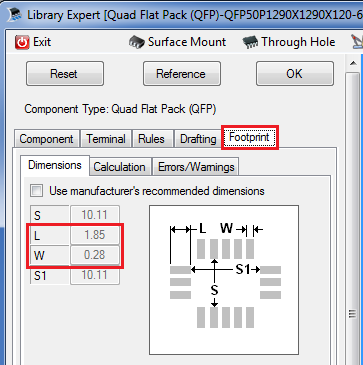

You can find the X/Y pad size in the "Footprint" tab -

The programmer responsible for that piece of code is on vacation and will return next week. Then we can get his feedback on the grayed out "Add / Delete" buttons in the Pad Stack Editor.
