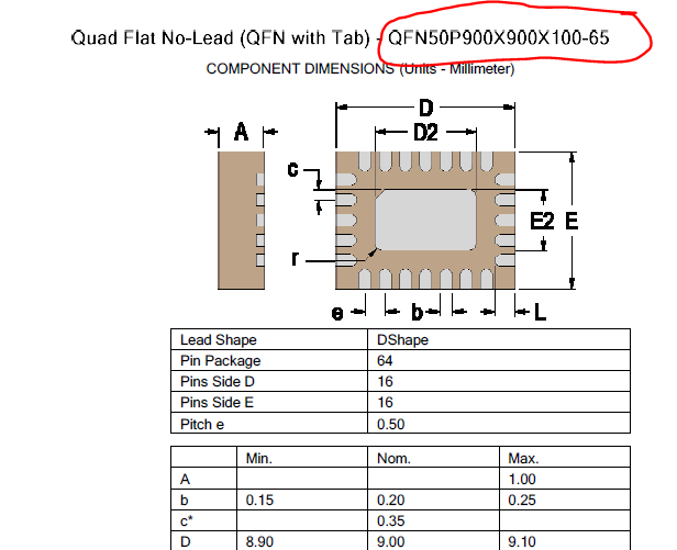

Thanks for adding the print feature - its a nice feature and works great.  AT the risk of being needy, I had another request.  I wanted to compare the differences between a QFN64 using the Nominal and Least settings and wanted to print to a PDF.
It looks like the print feature leaves off the Environment suffix.  I printed out both versions, L & N, and neither said which one it was.
It would help while doing these types of comparisons.
I know its not a priority but maybe in a future release you could include the suffix?
Thanks again!
Posted By: BryanT
Date Posted: 12 Jul 2013 at 2:27pm
Here is what I am talking about - didn't look like I was able to paste it in my last post:
Posted By: Jeff.M
Date Posted: 13 Jul 2013 at 7:30am
Eminently doable.
Date Posted: 13 Jul 2013 at 7:35am
Looks like you'll be getting your request in the next release, V2013.08.
Thanks for the recommendation!
