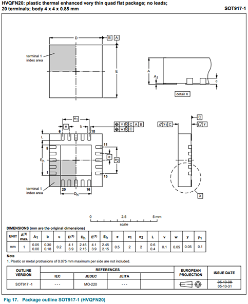

NXP Semiconductor Case Codes start with SOD or SOT followed by a number. NXP refers to their Case Codes as 'Outline Version' and it's placed in the upper right corner of the component package dimensions page in the data sheet. Nexperia is a spinoff of NXP and they use the same SOD/SOT prefixes for their Case Codes.
Here is the component package datasheet page with the Case Code SOT917-1 in the Upper Right.

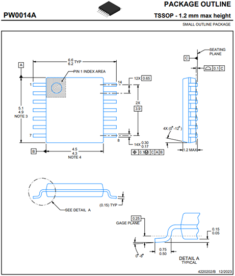

The original TI Case Code D R-PDSO-G14 was recently changed to D0014A. The D0014A Case Code is assigned to over 5,000 TI Part Numbers. Over the past 10 years, TI updated Case Codes for over 100,000 Part Numbers. If you're into creating large PCB library databases, you're constantly updating Part Numbers with new Case Codes.
Here is a footprint and 3D model for TI  Code D0014A.
Here is the component datasheet page with the Case Code in the Upper Left and package dimensions.
