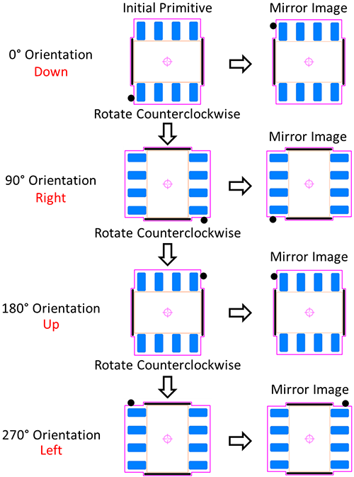

Printed circuit board technology uses geometry to define the rotational angle of every object in the PCB design. Objects use geometry to define the orientation starting at 0,0 which is located on the right center. Cartesian coordinates are also defined per the PCB or Footprint origin. Popular Pad and Footprint rotations are 0, 90, 180 and 270 degrees, but can be placed at any angle. Pad and Footprint orientations start at 0,0 and rotate counterclockwise.

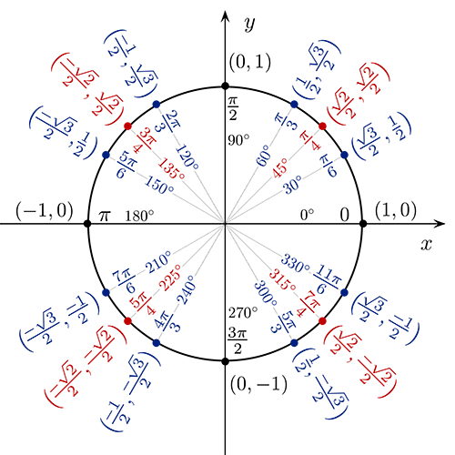

1. Pad Rotations Start at 0,0 in the Positive X Location
Pad rotation follows geometry standards.
Footprint rotations are in 90° increments starting with the zero-component orientation per the IEC 61188-7 Rotation B released in 2007 with pin 1 in the Lower Left corner. IEC 61188-7 reflects the same zero component orientation documented in the IPC-SM-782 standard that was released in March 1987.
The main reason to establish and follow a zero-component orientation is to help automate the assembly process. A known zero-component orientation will eliminate hours of research in PCB assembly trying to figure out the footprint rotations in the CAD library.

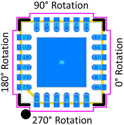

EIA-481-D Tape and Reel Quadrant Designations
EIA-481-D
CAD Library Zero Orientation Quadrants
Per all the JEDEC standard package definitions, quadrant 1 is where pin 1 should be located.
IPC and IEC use consistent rotations throughout their standard where EIA uses multiple rotation variations.
  • IPC-7x51 uses Quadrant 2 for Pin 1 Upper Left and Quadrants 2-4 for Upper Center
  • IEC 61188-7 uses Quadrant 1 for Pin 1 Lower Left and Quadrants 1-2 for Left Center
  • EIA-481-D uses Quadrant 1 for Pin 1 Lower Left BGA, SOIC, SOP, SSOP, QFNR, DIP
  • EIA-481-D uses Quadrant 2 for Pin 1 Upper Left TO-252, TO-263, QFNS, TSSOP
  • EIA-481-D uses Quadrant 3 for Pin 1 Lower Right for all SOT and miniature parts
  • EIA-481-D uses Quadrants 1-2 (Pin 1 Left Center) for PLCC, LCC
  • None of the 3 standards use Quadrant 4 for Pin 1 location

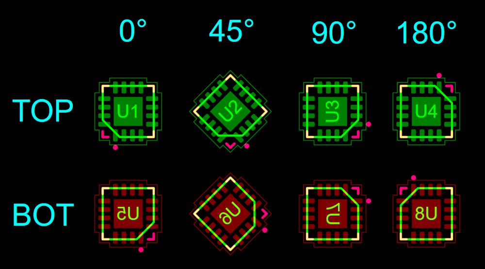

Is there an actual standard for bottom side zero component location and rotation direction?
I feel like this just depends on how the CAD tool happens to implement it.
There are tools that do it like this for example:
Points: 6092
Post Options Post Options   Thanks (0) Thanks(0)   Quote Tom H Quote  Post ReplyReply Direct Link To This Post Posted: 17 Feb 2025 at 4:50pm
In PADS Layout, the Bottom (Opposite) Side footprint rotation is clockwise.
The Top Side footprints rotate counterclockwise.
It could be different for each CAD tool.

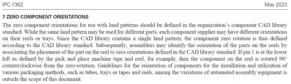

You need to know why IPC-7351 zero component orientation came into existence.
I joined the 1-13 IPC Land Pattern Committee in 1999 to help Dieter Bergman with a IPC-SM-782 software calculator to replace the IPC on-line land pattern calculator that was very expensive for IPC to maintain.
My first goal was in 2000 to transition from using imperial units to designing PCB library parts and PCB layout using the metric measurement system. The first calculator Jeff and I created was an Excel spreadsheet with called LandCalc. It was primarily SMD and only supported metric units. This was to run all tests to ensure the IPC mathematical model for min/max calculations was perfect.
The first calculators only had one rotation 'Pin 1 Lower Left' which was what the IPC-SM-782 supported since March 1987. After all, it was just an Excel spreadsheet and we didn't have the luxury of multiple rotations.
It took 2 years to add all the component families and finalize the min/max mathematical model. Then thanks to Philip Restall in the UK, we added a CAD tool translator for Mentor Graphics PADS. PADS was ASCII format so it was easy to figure out and we renamed the Excel spreadsheet to LandWiz. We freely distributed LandWiz on a website www.pcbstandards.com and had lots of downloads.
Then in 2003 we started writing code for the first software program which was Land Pattern Wizard. We shortened the name to LP Wizard. It was unique because there was only one footprint rotation 'Pin 1 Lower Left' because user feedback wanted us to fully dimension the resulting footprint to make it easy to QC.
Then IEC introduced the 3-Teir PCB library solution and we had to change everything to add the Least, Nominal and Most solder joint goals. This took another year to implement into the software tool.
We completed LP Wizard in 2004 with 3-Teirs, lower left was the zero component orientation and metric units only. We delivered it to IPC to test and replace their on-line calculator.
IPC was interested in getting volunteers involved in the approval process and were signing up volunteers quickly. We invited industry experts in join the IPC committee. Unfortunately, many of the volunteers turned out to be takers rather than givers. They attended meetings get information rather than provide information.
IPC had the final 1-13 Land Pattern Committee meeting at the 2004 IPC APEX conference in Anaheim, CA. We invited everyone in the local area to attend, especially members of local IPC Designer Council members. I spoke at the local San Diego chapter meetings regarding this new technology and try to convince everyone to transition to the metric measurement system. One attendee at the meeting was Jami Smith. He liked to attend IPC Designer Council meetings to learn more about standards in the electronics industry. Jami said he was interested in helping with the new land pattern committee, but the committee had already completed their goal of upgrading IPC-SM-782 to IPC-7351. But there was one more meeting at IPC APEX in Anaheim, CA and Jami Smith attended the meeting. He was about 30 minutes late getting to the meeting and when he entered, he recognized me and sat next to me. I was running the projector through my lap top showing the committee the new LP Wizard software program and the IPC-7351 draft.
80% of the attendees at his final meeting were newbies who never attended a single Land Pattern meeting. They were just people who wanted to learn more about the new standard. Also, this was the first and last IPC Land Pattern Committee meeting that Jami Smith attended. We were all set to finalize the standard when Jami stood up to address the attendees. He claimed to have knowledge of EIA-481 and insisted that the EIA zero component orientation for pick and place machines was Pin 1 'Upper Left'. No one at the APEX meeting knew anything about EIA-481 so they took Jami's word that he was trying to contribute information that we were unaware of.
Vern Solberg was one of the committee leaders and he suggested a committee vote from everyone in the room. Don't forget that 80% of the attendees had never attended a standards meeting before and they were asked to vote on an important subject. Karen McConnell the committee chairman was there and she agreed with Jami Smith. Then when everyone voted, they sided with Karen and Jami and that was the turning point for the IPC-7351 Zero Component Orientation. Jami Smith left the meeting and no one ever saw him again. But the damage was done.
It took us 3 - 4 months to change all the footprint rotations in LP Wizard. IPC-7351 was released in 2005. IEC got involved and chastised IPC for changing the footprint rotation based on faulty information and a rash decision at a meeting that no one had the knowledge of what impact they had on the entire electronics industry. So IEC released the IEC 61188-7 which reverted back to IPC-SM-782 zero component orientation.
Dieter Bergman and I had a conversation in 2008 about changing the zero component orientation for IPC-7351B, but Dieter said that once a standard is released it's very difficult to say you were wrong and here's the correction. Dieter shrugged his shoulders and said "Let the best standard win". However, in 2014 the IEC standard was winning and Dieter agreed to change the zero component orientation in the new IPC-7351C. We had the kick-off meeting at IPC headquarters the week of July 15 - 19. We created the entire framework for the new totally upgraded IPC-7351 standard. I left the meeting and flew back to San Diego, CA and immediately started working that weekend on Chapters 5 for surface mount and 6 for through-hole. The following week on July 23, Dieter Bergman passed away. This was a devasting loss to the electronics industry but I was inspired to carry the torch and spent the next year writing the IPC-7351C with Rainer Taube in Germany. We introduced IPC-7351C to the Land Pattern Committee in 2016 and we worked on refining it for 6 years. Then we found out that Dieter never had the approval by the IPC executive committee for IPC-7351C and they shelved it, never to be released.
Bottom line is that the Pin 1 in the upper left for xero component orientation should have never been released and Jami Smith will go down in history for changing a standard that he had no business being involved in. Jami disappeared never to be heard from or seen again.
And now you know - the rest of the story...

Here's the IPC-7352 correction on Zero Component Orientation.
