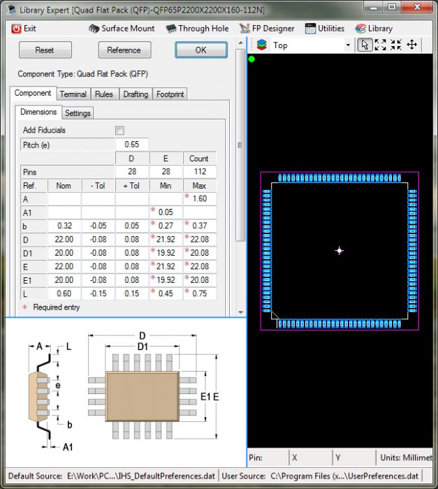

We have a contract stuck in a holding pattern until a few specific parts can be found/built, most notably case 987-03 (112 pin LQFP 20x20x0.65).  If I knew this part was on your list of 5000, or coming very shortly (actual date), I would happily move ahead with your tools.  Otherwise the search continues.
I was unable to successfully create this part using your "lite" version.  The moment I enter extent dimensions 22x22 the tool lists 88 pin count and nothing I can find seems to allow me to create the full 112 pin footprint.  I concluded that this is either a limitation of the lite version or requires changes to the preference files which are not editable in the lite version.  The help/videos seem to focus more on special cases than on daily library tasks.  We do not have the luxury of hiring a full time librarian, so parts are a real time sink for us.

Nothing limits the pin count.
To get 112 pins you must enter the number of pins on the X and Y sides not the dimensions of the X & Y sides.
For the part you're trying to build I suspect that value is 28 x 28.

This part can be built very easily (when you use the correct number of pins/side, per Jeff's post) - I built it in about a minute.
I would highly recommend that you bite the bullet and purchase the tool - you won't be disappointed (and it will save you hours of effort).

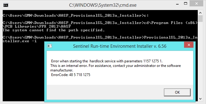

Yes I see now that I entered dimensions instead of pins,,, gazing waaay too long at datasheets I guess.  And yes, I took the leap and purchased the tool.  However, while waiting for my key to arrive, I tried installing the evaluation license and ran into a "Sentinel driver incompatibility with Windows 8.1 AMD x64."  The first attempt reported the incompatible driver.  Subsequent attempts fail with the following:

Looking at the DOS window, the bat file is looking in a folder \FPX 2013\HASP.
My installation created \Library Expert 2013\HASP
thus the file not found error.   I can try editing the bat file I suppose.  Not sure what to do about the driver incompatibility.  The error dialog had a button to check online, but clicking it did nothing obvious.
Ah the woes of setup...

No luck.   I'll wait for the real license.

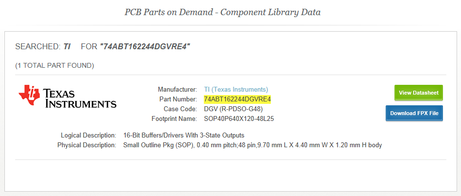

Sneak peek of www.PCBLibraries.com/POD; it will be integrated with the forum, and we're thinking of rewarding the most active users in some way as well.
