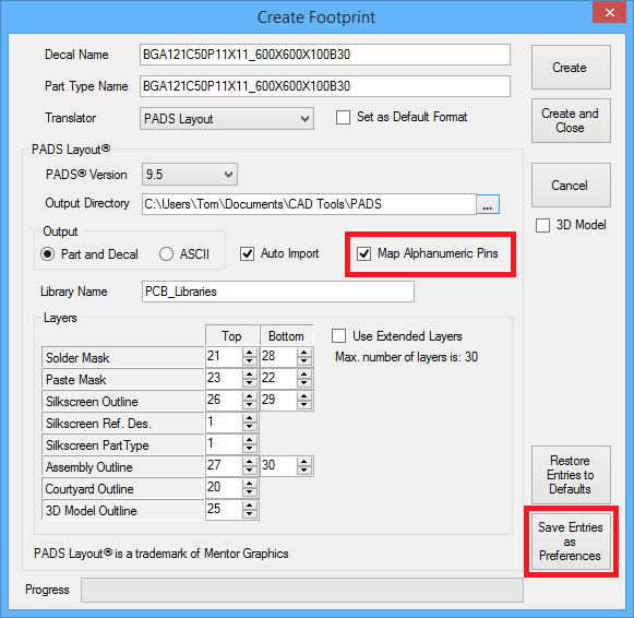

PADS Layout attributes default to the "Part Type". This includes Pin Rename and Alphanumeric Pins.
If you want Alphanumeric Pins to always be in the "Part Decal" then unselect the "Map Alphanumeric Pins" option in the CAD Tool Export menu and select "Save Entries as Preferences" so that it is always unselected.
