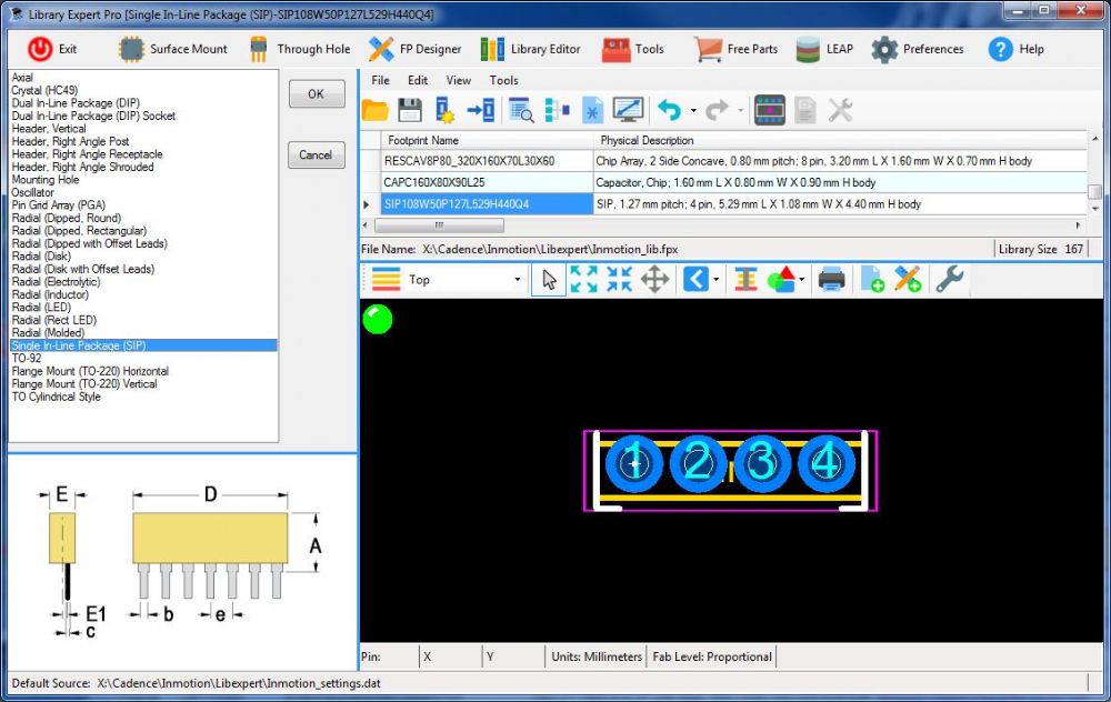

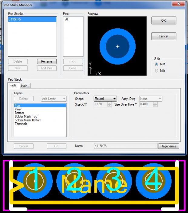

I'm creating a 4-pin SIP Hall sensor (Allegro A1363) FP and want to increase pad clearance by using an oblong pad instead of a round one, but Pad Stack Manager won't let me do that.
Why?
Cheers, ...
Post Options Post Options   Thanks (0) Thanks(0)   Quote Tom H Quote  Post ReplyReply Direct Link To This Post Posted: 03 Nov 2016 at 7:04am
You Must create this part in FP Designer.
The Calculator does not have a Oblong Through-hole pad stack option.

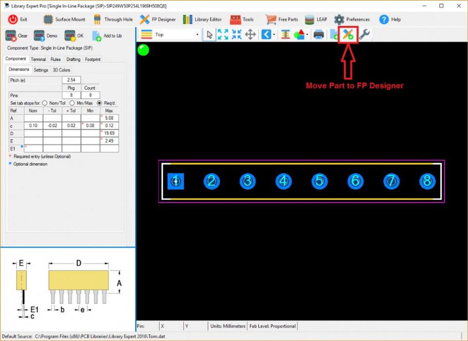

Post Options Post Options   Thanks (0) Thanks(0)   Quote Tom H Quote  Post ReplyReply Direct Link To This Post Posted: 03 Nov 2016 at 7:29am
There is a button to move your Calculator part to FP Designer.
However, these component families will not transfer - DPAK, TO220, TO92, Mounting Holes, Aluminum Electrolytic Capacitor.
BennsPCB View Drop Down
Joined: 30 Jan 2013
Location: Sweden
Points: 98
Post Options Post Options   Thanks (0) Thanks(0)   Quote BennsPCB Quote  Post ReplyReply Direct Link To This Post Posted: 03 Nov 2016 at 7:37am
Tried that, but all data except the pins disappeared. Not very useful.

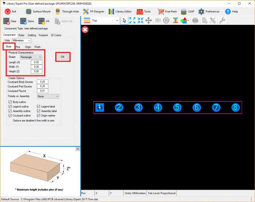

Post Options Post Options   Thanks (0) Thanks(0)   Quote Tom H Quote  Post ReplyReply Direct Link To This Post Posted: 03 Nov 2016 at 7:43am
Did you select the "Body" tab and enter the package dimensions?
Joined: 30 Jan 2013
Location: Sweden
Points: 98
Post Options Post Options   Thanks (0) Thanks(0)   Quote BennsPCB Quote  Post ReplyReply Direct Link To This Post Posted: 03 Nov 2016 at 8:21am
Nope, I came from Through Hole/Single In-Line Package (SIP), where I have entered all my data.
It's from here it would be useful to enter the FP Designer. (with data intact) Wink
