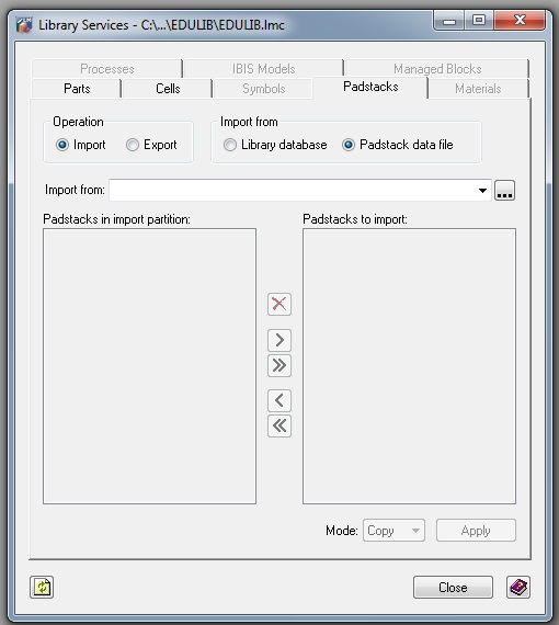

I'm using PADS Professional software, and I'm novice,
I'm trying to create a new cell by using pads library tools, but i need to import pad stack datafile to use it in the library services.
How can I find or download the pad stack data file?
Thank You

Post Options Post Options   Thanks (0) Thanks(0)   Quote fjp1369 Quote  Post ReplyReply Direct Link To This Post Posted: 18 May 2021 at 2:47am
Thank you,
But before setting the footprint expert library,
I need to load a pad stack data file to "Library Services" and my problem is that I don't have any pad stack data file to upload it,
I have followed the procedure represented in below link :
I will be so appreciated if you help me.

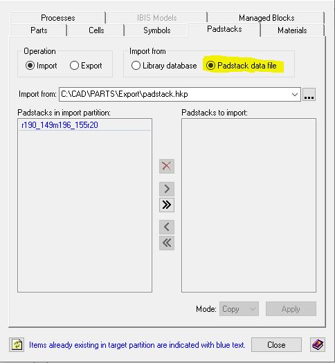

Post Options Post Options   Thanks (0) Thanks(0)   Quote bcarter211 Quote  Post ReplyReply Direct Link To This Post Posted: 07 Sep 2021 at 8:20pm
You need to select Padstack Data File option:
This will allow you to browse to the location of your *.hkp padstack file. You need to do the same for importing *.hkp files for your cells and your parts database (parts) also.
