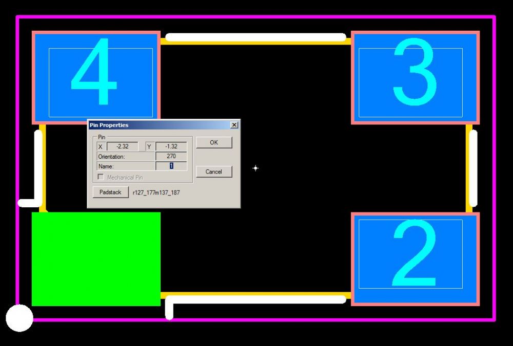

When building a Oscillator Corner Concave.
In the generated padstack the Y width exceeds the X width and has a 270 degree rotation.
The pad could better be generated with a 0 degrees rotation and a X width exceeding the Y width.
This keeps the Pad Stack Library cleaner with less entries.

Post Options Post Options   Thanks (0) Thanks(0)   Quote PLTcbv Quote  Post ReplyReply Direct Link To This Post Posted: 26 Sep 2014 at 12:13am
This is the default view when making a part.
The pad orientation is "270" and should be "0".
If you use the Padstack Designer you can't create an offset in the Padstack when Y exceeds X.
So i.m.o. always let X exceed Y.
If you convert to Expedition ASCII out rotations are not cleaned up.
So we have one pad with orientation "0" and one pad with "180"
