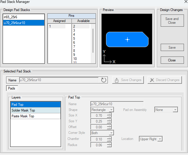

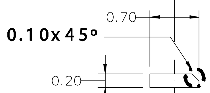

I want to set the pad corner style only on one edge because the pad looks like this:

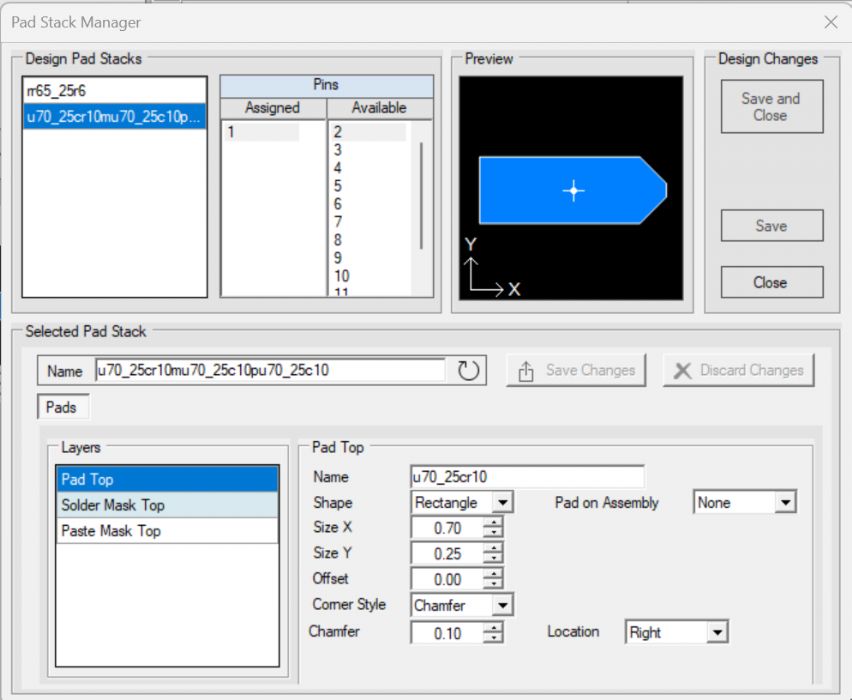

The editor does it on both edges:
Points: 6104
Post Options Post Options   Thanks (0) Thanks(0)   Quote Tom H Quote  Post ReplyReply Direct Link To This Post Posted: 21 Nov 2025 at 7:53am
In the Pad Stack Designer select the Pad Shape 'Both' Rounded & Chamfer.
Then make the Rounded radius zero '0' and make the Chamfer any value.
Then move the Chamfer Corner to any corner.
Let us know if this works for you.
pcbinfratec View Drop Down
Joined: 19 Nov 2025
Points: 6
Post Options Post Options   Thanks (1) Thanks(1)   Quote pcbinfratec Quote  Post ReplyReply Direct Link To This Post Posted: 21 Nov 2025 at 2:40pm
Just beautiful.
I missed the 'both' option.

Post Options Post Options   Thanks (0) Thanks(0)   Quote Tom H Quote  Post ReplyReply Direct Link To This Post Posted: 21 Nov 2025 at 3:15pm
You can turn the radius off by entering a zero '0' value.
You can move the chamfer to any corner.
Or you can have both radius on 3 corners and a chamfer on one corner.
