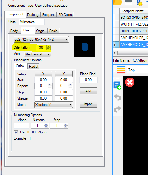

Post Options Post Options   Thanks (0) Thanks(0)   Quote Jeff.M Quote  Post ReplyReply Direct Link To This Post Posted: 09 Nov 2016 at 8:46am
Pad stack orientations are limited as previously noted.
Pin orientations aren't.  Query the pin (left click, right click) then select Properties.
You can set the pin orientation there.
