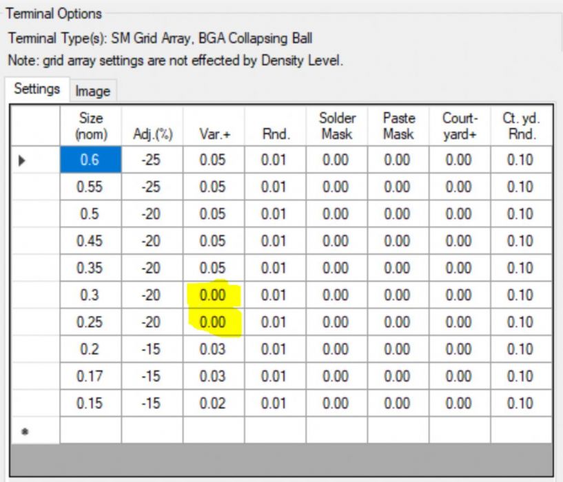

These two values in the IPC-7351C preferences looked like they don't fit with the rest.
Are they correct?

They are correct. But you can change them to whatever you want.
IPC-7351C is a guideline, not a Standard.
